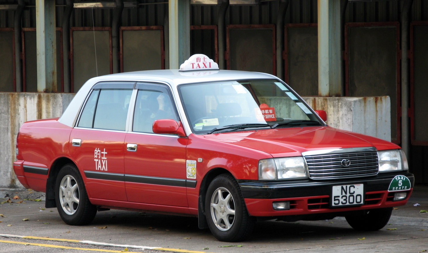

    Hong Kong taxi drivers drive super luxury versions of some Toyota or the other.

    Now you're testing me - I don't remember it as a CROWN or CRESSIDA, as Australia had had them earlier. Though, the square front looked a bit like the 95-99 photo, so could have been, but I suspect older than that, a bit squarer too maybe.

    Haha. Could be a Cressida.
    At one point, Toyota Australia was selling Avalons to you guys (around the early 2000s) which were last generation Avalons. We had just moved on to a new generation. I thought that was pretty clever because it's halfway around the world and it extends the life of the old Avalon.

    Yeah, could have been a Cressida, which, in the home market might have had a different name, and still badged that way in FIJI - we had a few come here as grey imports I think were called Mark 2 or something?
    I think older than either of those photos. We had some of the Avalons at work - weren't bad cars actually, and they were cheap, probably because they were older stock. They were popular as TAXIs here too prior to PRIUS & Camry hybrid taking over.
