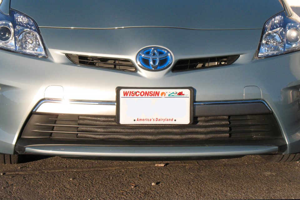

    So this all leads to another topic that we should all be doing when it's cold enough: Grill Blocking! :)

    Did some one say grill blocking time? OK! :D
    ElectronFlux likes this.
  16. john1701a
    john1701a Prius Guru
    Jan 6, 2004
    12,840
    5,312
    That looks familiar. I blocked mine last Tuesday. It's time.
    retired4999 likes this.
  17. markabele
    Mar 27, 2012
    5,084
    1,782
    Nebraska
    Think you'll block the top when it gets a bit colder?

  19. retired4999
    Aug 11, 2011
    2,652
    627
    Eau Claire, Wi.
    Nope, keep the inverter cool!
  20. markabele
    Mar 27, 2012
    5,084
    1,782
    Nebraska
    Are you saying this because the inverter gets more work in our PiPs? Or would you say that if you had a regular Prius, too?
