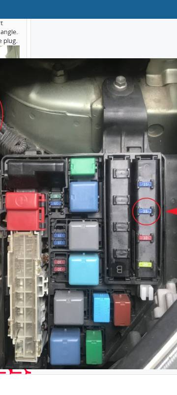

    Where exactly is the AM2 fuse? Thanks

    It is in the underhood fuse box - black box on the left (driver's side) of the engine compartment.
