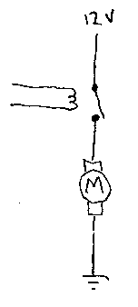

    Imagine, say, a pump from the old fragrant days.
    A motor, two wires (+12 V and ground), a relay to start and stop it. What could be simpler? If it wasn't pumping for some reason, there was plenty of daylight left at the shade tree to dig in with our meters and start trying to find the problem. Is the relay closing? Is the pump getting voltage across it, but maybe not enough? Is that because of a problem in the 12V supply? Bad relay contacts? Or is it on the other side, and the ground connection is bad? Does the voltage only look inadequate, because what's really happening is the pump is locked and drawing too much current, pulling down the supply? Or is the supply OK and the pump is drawing too little current, maybe because the brushes are worn? Nothing complicated here, just simple elimination, and with enough persistence, ruling the choices out one by one, digging down to the right wiring connections to tap in with the ol' meter and test each idea, we were pretty much guaranteed to track it down to the root problem before dark.

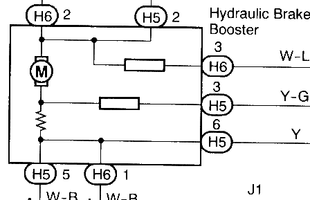

    Now a pump from the cold, soulless Prius days (2001 manual, page DI-417):
    Egads, what's wrong with this thing? It's got more wires on it than a character in The Matrix. What kind of nut thought a pump needs seven wires? And a built-in resistor? What's up with that?
    Ok, for starters, it's not that bad really; the connections at the bottom are just ground and those at the top just 12V from the relay(s), as before. They're both doubled up here because this is no aquarium bubble pump.
    It's those white-blue, yellow-green, and yellow wires off the side that are something new. All three of those run straight back to the computer. It just watches them. That's the only reason they're there.
    What if this pump isn't pumping for some reason? Not getting 12V? All three sense wires at 0. Bad ground? All three high. Poor connection upstream? All three low. Pump drawing too much current? White-blue pulled low, yellow-green rises. Pump tired and not drawing enough? White-blue stays high but yellow-green rises less than normal.
    To find out which of those possibilities the real problem is, you ask the computer and it tells you. It's been watching those sense wires all along, so it already knows. Then you go straight to that area, find the culprit, and fix it.
    So for sure in this new game, you don't want to show up without the tool for asking the computer things. That's now just about equipment necessity #1. Also important, access to the manuals. The scan tool may add little one-liner descriptions to what it gets back from the computer, but often not enough that you'd know what to make of them if you didn't have this picture in front of you. Once you do, you can sit in the comfortable chair with the cold drink and piece together the evidence until the aha! comes.
    I could be accused of overselling somewhat. The computer here has not told us exactly what the problem is and how to fix it. Suppose it said the ground is bad. There's still old fashioned poking around to find out where and why. Whoever expects the computer to give all the answers will feel baited and switched when it can't. In this case, all it has done is instantly ruled out four whole areas out of five and indicated the one to focus on. But that helps a lot, especially if the sun's getting low.
    So it's not so much "need a computer to figure things out" as "can use the computer to figure them out way faster than you ever could otherwise."
    One thing that's true is that the new game will feel unwelcoming and impenetrable to a person who's all closed off to learning new ways to play. If someone is offended by the computer and won't ask it questions, then they pass up all the time they'd save by finding out what it knows, and end up just trying to poke around the old way, and getting all frustrated about these stupid pumps these days with their half dozen wires like dagnabbed Medusas. Ironically enough, the extra wires are only there to be a huge help in diagnosis, but to someone who's ignoring that help, they're just in the way.
    So, yeah, the game changes a little, but only to the kind of game you might appreciate these days if you gave it a try. Pour that cold drink, sign up on techinfo.toyota.com and find that comfortable chair. Your days of doing your own work don't have to be over.
