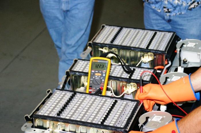

    Seem like you could just buy the HA fan harness for around $180 and then build the charger yourself and hook it up, should work if you wanted to skip the research part.
    You can see the fans in this pic here:
    Dylan Doxey likes this.

    The picture of the 3 fans, I think they are all interconnected. One harness plug should be able to power all of them.
    That battery pack looks very robust.....I would hate to work on it. lol
