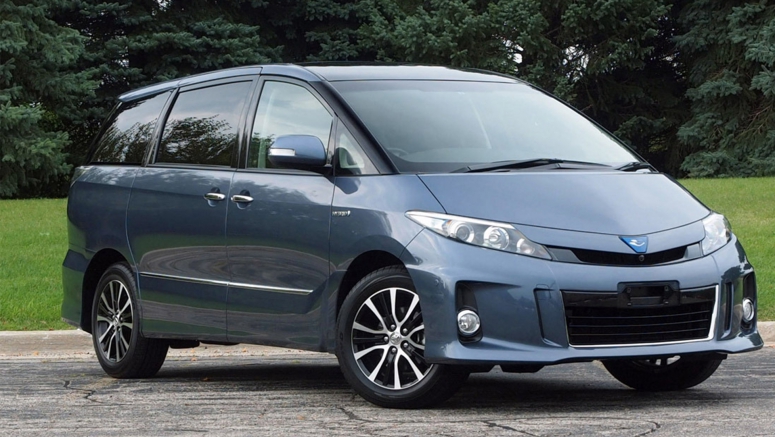

    Here's a comparison of the exterior dimensions:
    Prius v / Mazda 5 / Toyota Estima / Toyota Sienna
    Wheelbase (in): 109.4 / 108.3 / 116.1 / 119.3
    Length (in): 181.7 / 180.5 / 188.8 / 200.2
    Width (in): 69.9 / 68.9 / 70.9 / 78.2
    Height (in): 62.0 / 63.6 / 68.9 / 68.9
    Box Volume (cuft): 455.7 / 457.7 / 533.7 / 624.2
    Weight (lbs): 3274 / 3457 / 3803 / 4310
    US Base MSRP: $26,750 / $21,240 / ???? / $28,600

    "Size-wise, the Sienna is: 200.2-inches long, 78.2-inches wide, 68.9-inches high, and wheelbase is 119 inches. The Estima is 188.8-inches long, 70.9-inches wide, 68.9-inches high, and wheelbase is 116.1 inches. The Alphard is 191-inches long, 72-inches wide, 75-inches high, and wheelbase is also 116.1 inches." - Toyota's Fuel-Sipping Estima And Alphard Hybrid Minivans – Off Limits For US - HybridCars.com
    The Alphard is a fancy pants Estima, but the article mentions its curb weight at 4200lbs. The weight for the Sienna above is for the base L. The LE is 4450 and XLE 4540 for the FWD versions. The HSD in Camry adds 245lbs.
    The Alphard and Estima are AWD and get 44mpg on a Japanese test cycle. Exact one not mentioned, but the Prius gets around 70mpg, if not higher. So these minivans would likely get around 31mpg on the EPA. They do use an older generation of the system in the RX with a 2.7L engine though. The Esquire minivan is newer and sounds like is using a version of the HSD from the Prius. It gets 55mpg on the Japan test, so around 39mpg expected on the EPA. Sounds good, but it is 'somewhat smaller' than the Sienna. Forbidden Fruit: Toyota Esquire Hybrid Luxury Minivan
    It would come down to educating the buyer on the savings potential, and pricing it right. That hasn't played out with the HiHy. It did well at first, but that was when your choice was it or a Prius followed soon after by the Camry. There is now the v among other choices. Not to mention it is also Limited AWD only. The 8mpg it gains isn't enough for most buyers to spend the money.
    While higher priced and larger vehicles have better margins than compacts, the unibodies used in crossovers and minvans don't enjoy the amount that body on frame pick ups and large size SUVs do. While I wouldn't be surprised if Toyota has a current generation HSD between the 2.5L and 3.5L that could fit the bill for an American minivan, they still have to price it right. A person buying a minivan most likely has more than one kid, so will be more cautious on such large purchases.
