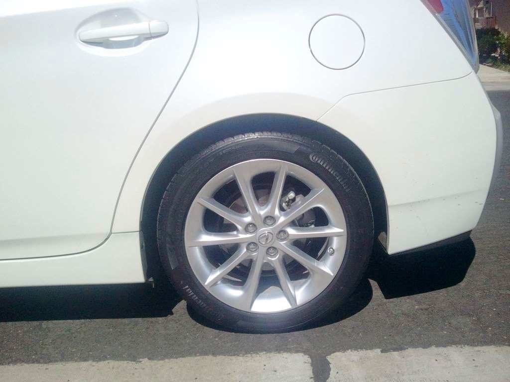

    I bought some 215 45R 17 and in putting them on a set of 17" TC rims ( which look very nice)
    I also feel there is some wheel gap. Agin what size might eliminate the look and no adverslely affect
    handling or MPG? Taller? Narrower?
  19. F8L
    Aug 14, 2006
    19,011
    4,082
    Grass Valley, CA.
    I really like the look of the 205/50/17. The only drawback is the tire I bought rode kinda rough but it was getting better as they broke in. I switched them out for a set of 215/45/17s and immediately regretted it from appearance standpoint. If I get the chance to do it all over again I will go with the 205/50/17 Ecopia EP422 for max fuel economy or the Bridgestone Serenity Plus.
    Gap with 205/50/17
    Gap with 215/45/17
    It's not a huge difference but very noticeable when viewing the car in person. This size also fixes the speedo error so it reads accurate.
