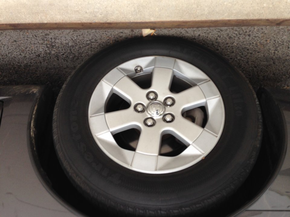

    True, and forgive me for keep on going, what I don't understand is whether it's actually possible to mount 195/65/15 tires on the OE rims (on the inside of the door it does say 185/65/15, so it's OE wheels with new tires, I presume)?

    They would mount just fine. The wheels are 15x6". A 195 will fit on a 6" wide wheel without issue. A 205/65/15 would mushroom out I believe.

    But that's the thing, we have currently 205 tires on OE wheels... Hmmm, I'll just get the 195 and hopefully all is good :)

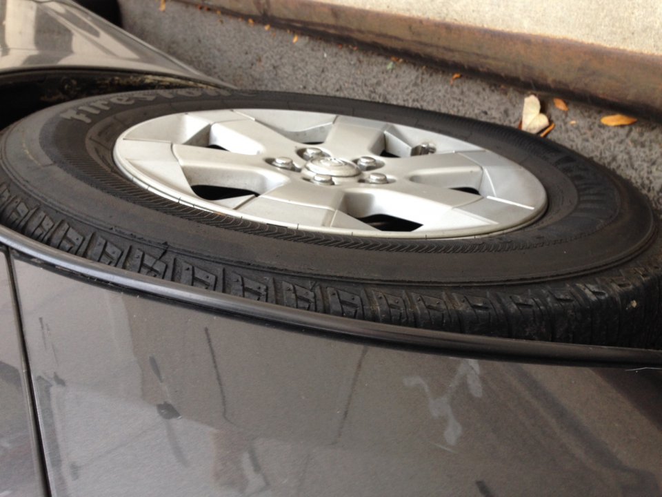

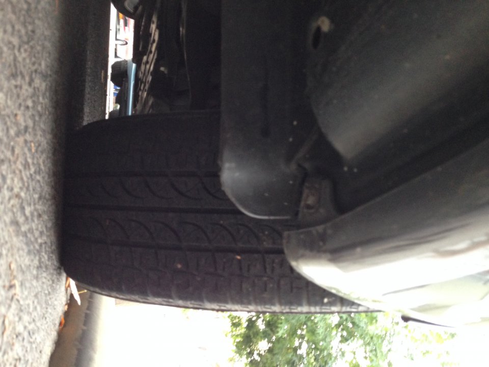

    Take a picture of the wheel and tire from the front then a side profile view. Post it when you get a chance. I'm interested to see how it fits.

    Voila, does these work?
    Ordering the Ecopia EP422 195/65/15 this week...

    Yup. Those are the OE wheels and the 195/65/15 will fit.
