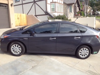

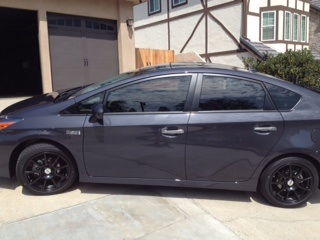

    So I did about as much research as I could possibly do before pulling the rest of my hair out.
    17x8 TSW Interlagos with Yoko Envigor in 205/50/17.
    I will report back but initial drive is awesome. Way more stable and the car wanders a lot less. No idea what it will do to the MPG's. Bad pics and the silver center caps are ugly so I will fix both ASAP

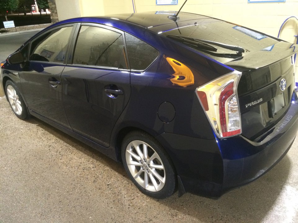

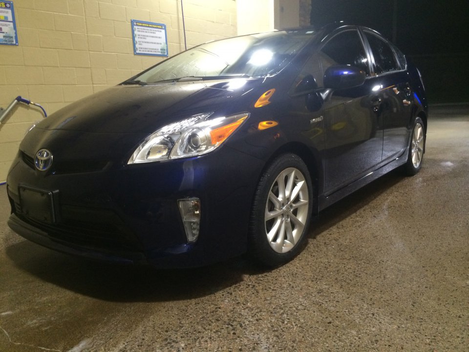

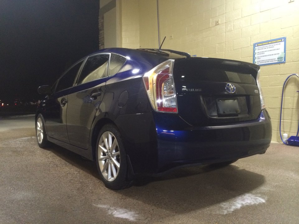

    IMG_1944.JPG IMG_1945.JPG IMG_1946.JPG So I am in the same boat^.....I read through a thread where it was mentioned that 205/50/17 was the best size for 17" wheels and I bought a set of pure contacts. Wish I would have paid a little more attention to which vehicle it was recommended for as I have a 2013. First I have to say holy chit have I been missing out! I have been rolling on a set of Yokohama's only because I got an incredible deal but managed to puncture them a couple times from screws which caused me to be in the position I am in now! The Yok's were SO LOUD that I truly had no idea how much better the ride could be! Noise levels are great so far and the tires seem really sure footed on dry pavement but I still need more time to assess properly obviously. I just hope the size will be ok because the wife will not let me spend another penny! Also I should point out that right now discount tire direct is doing a promotion through ebay. The best deal I could make, including the repeat customer discount was $497 shipped for these tires. But add the replacement certificates and the price went much higher. I managed to get all four with certificates shipped to my door for $516! Also...apparently the retail stores and disc. tire direct will finally be merging. I wonder how that will work with tire prices now. Also...these are the best pics I have for now

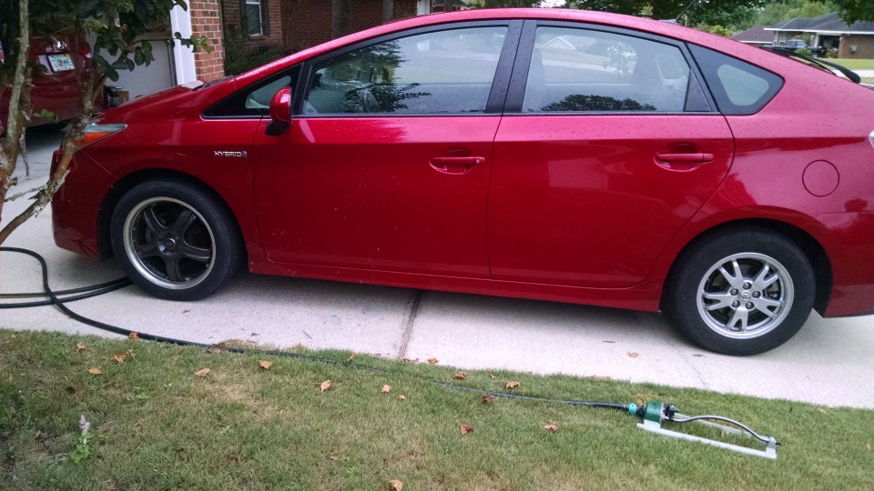

    Need new tires, should I go with the 17" wheel (shown on front) or the standard 15" (shown on back)?

    Fl8216. Both look good! If fe means anything to you stick with the stock set-up. H
