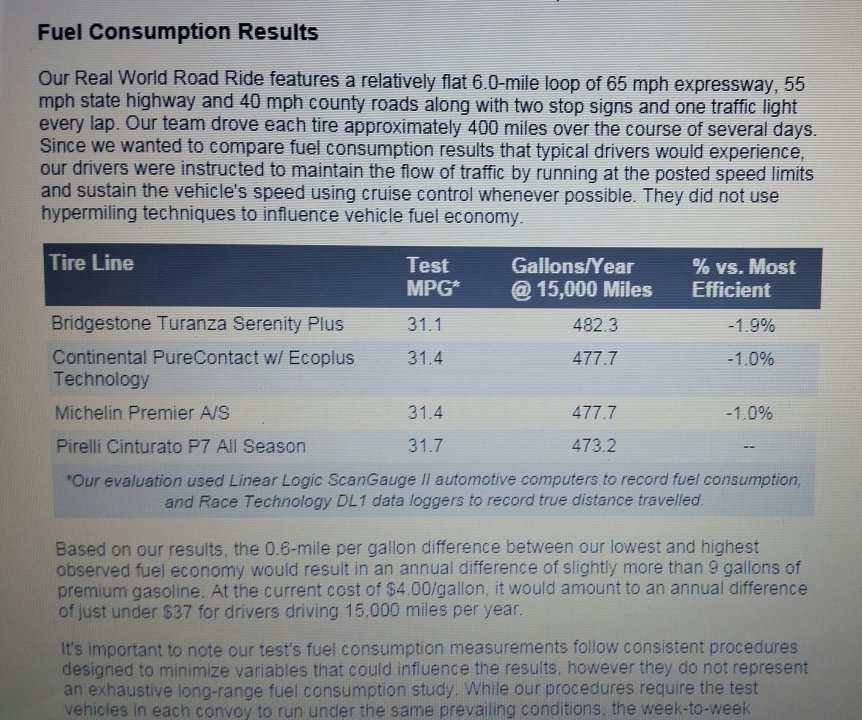

    How does Pirelli Cinturato P7 ASP compare to the PureContact? A recent Tirerack test comparing the Premier with these shows a little FE advantage for the P7 but was wondering if there's a real world consensus out there.

    I think the difference is quite small. Maybe 1mpg in a Prius. Still, I would consider it an option if total mpg in a 17" tire was your highest priority. I can't remember how it rates for snow traction. It does well in other respects and TireRack customers really like it. It's also supposed to offer a nice ride which is nice compared to the PureContact which is a littler rougher. Now that mine are broken in they feel fine most of the time.
