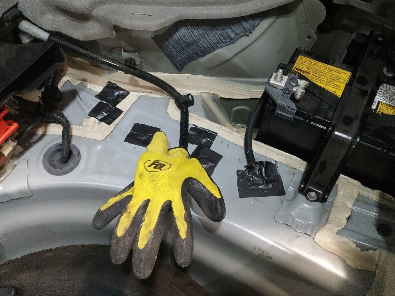

    Have you tried this in a Gen III Prius? Let's say it works on a Gen 3 Prius. Let's say some guy took your advice. He started to work on his car following your advice because you said it's OK. He accidentally let the positive terminal touch metal and created a short. That in turn fried his DC-DC converter. He's out 4G cause he was dumb enough to follow your advice.

    I just replaced my battery about a month ago so I know exactly how the positive terminal looks. And yes, there's a plastic removable insulator that the owner has to reattach after removing the terminal, but accidents do happen. What happens while he tries to slip the plastic insulator into the terminal and the terminal slips away from his hand and shorts out? The terminal has a 140 amp fusible link. The Prius DC-DC converter is rated at 120A. Guess which one's gonna go first in case of short? I put a glove over my terminal as soon as I remove it from the battery post for protection but not everyone's gonna do that.
    The only way I would agree with your advice is if there's documents from Toyota that shows the charging system's output is no more than 14.4V without battery attached AND that the battery cables are connected to the battery with an Anderson plug which it's not.
    You can get a cheap trickle charger from harbor freight for less than $10. If any accidents happen, only the charger is fried. The factory battery cable is more than capable of handling 1 or 2 amps of current. You're out a cheap trickle charger that you're very likely able to return. If you really want to be on the safe side, put a 1 amp fuse on the trickle charger. Besides, probably nothing will happen to the charger because most modern chargers have short circuit protection.

    Aha! I now see how we ended up at cross purposes, and some of it was my fault. From your photo, it appears that Gen 3 no longer uses the unpluggable cable connectors at the positive terminal, as found in Gen 1 and Gen 2. (That's too bad, 'cause it's really convenient. The oil filter access and turning radius were already two reasons I wasn't hurrying to upgrade from my Gen 1, and now this ... darn.)
    I see that this thread is in a Gen 3-specific forum, so it was natural for you to assume my comments were specific to G3, and it would have been better for me to notice that at first and write a big "if it's the same as G1 and G2..." at the top. As it happens, I saw the thread in the site-wide Recent Posts list and I wasn't careful to check what specific forum it was. That, combined with my not knowing that Gen 3 had dropped the feature I was talking about, led me to make a comment that didn't quite fit the forum it was in.
    Fortunately, anybody thinking to follow my suggestion on a Gen 3 would have immediately reached the point "hmm, Chap talks about an insulated plugin connector I can simply unplug back here, and I'm looking and there isn't one, something doesn't fit." That's an important backstop, one of the reasons I do put that level of detail into my posts: so if something I'm saying doesn't fit your situation, you can tell it doesn't.
    A quick "hey, Chap, you're talking about an insulated unpluggable connector at the positive battery terminal, have you heard that's not there any more in Gen 3?" would have brought us both to this point in one or two easy posts instead of four or five testy ones, and for my part in that, and not seeing earlier that's what was going on, I apologize.
    Anyway ... that's interesting. Can you describe what type of fuse they are now using for the battery end of the cable, and exactly where it's now located? Have they changed from the Yazaki B1-type (PAL male bolt-in) from Gen 1 days, to some other fuse type?
