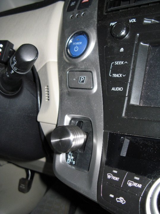

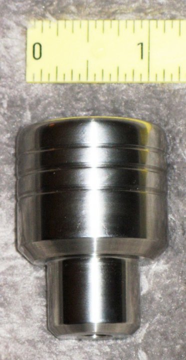

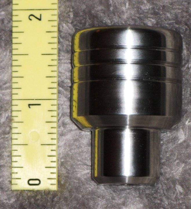

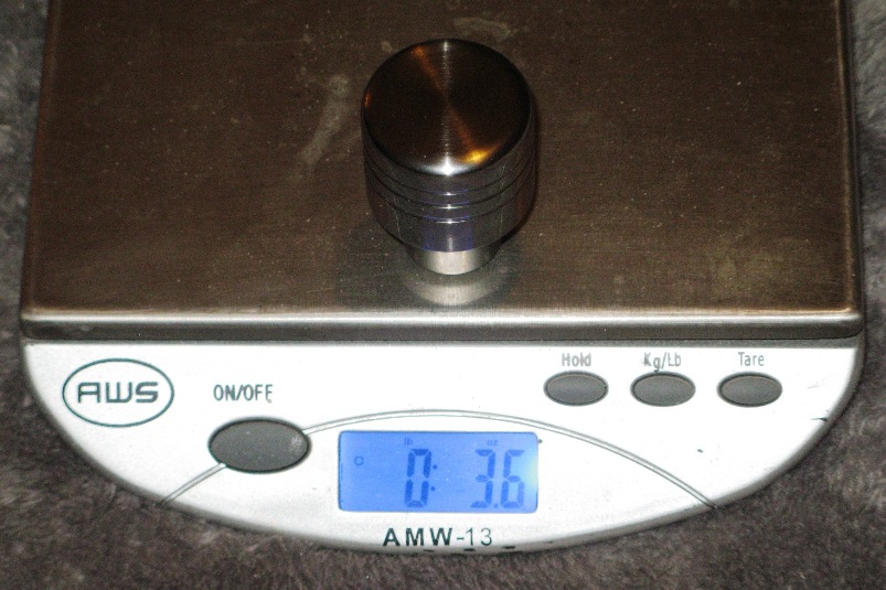

    With a whole week of experience, I learned a lot about titanium and making a solid titanium shift knob for my Prius"v.'
    While I learned a lot about machining and finishing titanium, it is not an experience that I savored.
    My experience in the aerospace industry never involved titanium. My expertise is with aluminum alloys.
    I first did an extensive search of the web on titanium shift knobs and all of my technical references on titanium. None of the makers will tell you what grade they use. Obviously, they are probably using the pure titanium grade 2, which has the hardness and strength of standard 6061 commercial grade aluminum.
    Grade 5 alloy consisting of 90% titanium, 6% aluminum and 4% vanadium is the alloy known as aerospace and medical grade. It is twice as strong and hard as high strength 7075 aluminum alloy and much more durable and scratch resistant.
    The grade 5 alloy is the one that you will NEVER see advertised in "solid titanium" shift knobs. It is nearly six times harder to machine as grade 2.
    It took me 6-8 hours for five days to successfully make two shift knobs. I initially started three, but one was destroyed as quite a few band carbide lathe tools as well as a bi-metal band saw blade.
    So, I've attached photos of one that was successfully completed and installed on my Prius"v."
    Also, I am glad that the experience is OVER. I am just happy that I have one very exclusive shift knob and the experience gained.

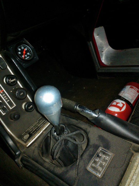

    A fellow Datsun Roadster aficionado working at the Marshall Space Flight Center made a run of shift knobs for us in 7050-T76511 Al alloy on his lunch breaks. Nice to have a little Shuttle/ISS-grade hardware on a 45 year old car.

    Air_Boss, a photo please.

    Put away dusty Shifter.jpg for the winter, but...

    The vintage light blue-grey looks very distinctive. It looks like it held up well.

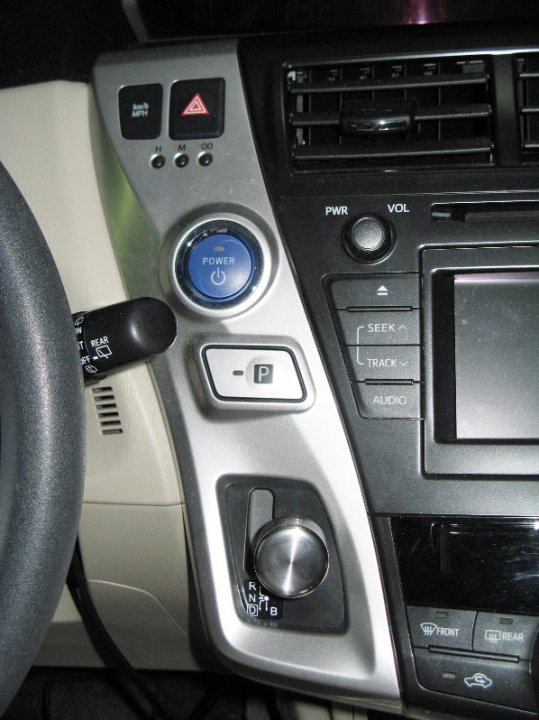

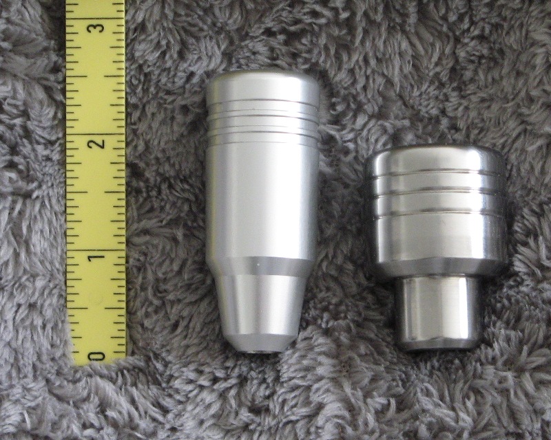

    I tried adapting the Razo LS137 knob made for the Gen III Prius for the Prius"v." I was, however, disappointed on how narrow the head was. The "three finger grab" using the thumb, index and middle finger felt awkward on the 15/16 inch or 25mm diameter.
    The 1-3/16 inch or 33mm diameter feels just right for the "v" and would be a "natural" feel for the Gen III Prius (M6x1.0 threads), Prius "c" and any Toyota automatic shifter using M8x1.25 threads.
    In the near horizontal mode of the Gen II's and the "v" the "three finger" grip on the grooves feels ergonomically good.
    For the Gen III's and other Toyota automatic shifters, the "golf ball" sized knob feels very ergonomically natural, when the "three finger" grip is used with the finger tips landing on the turned down "collar" of the knob.
    I have attached a side by side photo of my improved pattern next to the Razo knob, which I found to stick out too much on the "v" and less functional in the vertical mounting mode for other Prii.
