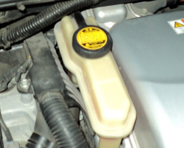

    Ok, do what Patrick suggested about checking the turbulence in the inverter coolant reservoir.
    Also, it would be wise to visit a dealer that has the correct device whereas the codes can be read.
    I would also make note of what Patrick said in #2 and 3 above.
    So far it sounds like a hybrid failure. The question is what part of it though. Look at the coolant reservoir and report back. NOTE: The Prius MUST be in "Ready" model when the fluid is flowing.
    If the fluid is flowing, it normally looks like the level of the fluid in the rear of the bottle is higher than the front, plus if you remove the cap on top you would see the liquid moving inside the bottle.
    What we need to know now is if you see the fluid moving when the Prius is in "Ready" mode.
    The bottle looks like what is pictured below. You will find it under the hood.

    When in ready mode I waited a few minutes from the time I put the car in that position and checked inside the reservoir and there were subtle bubbles in there. The voltage in diagnostic on the screen showed a voltage of 12.4 when in ready mode and did not move from ready to IG-on
