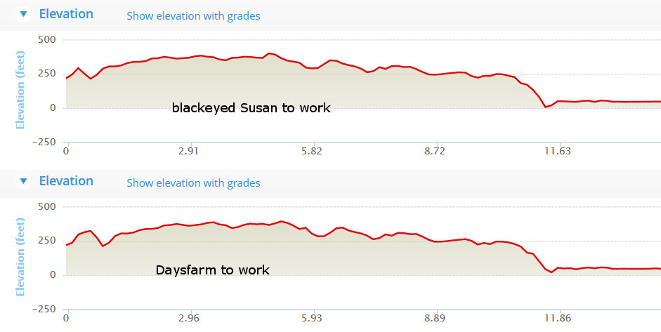

    the route from my place up black eyed susan and around to beulah via browns mill is .7 miles going up the hill on days farm directly to beulah is 1.01 to the same point. and the hill on days farm is higher than the one on blackeyed susan. going on blackeyed , based on topo maps is about a 50' less of a hill, but it over a shorter distance IE steeper hill.
    here are two screen captures from mapmyrun showing the hill profile on the different tracks all the way to work. after about mile 4 it all down hill going to work...
  15. bwilson4web
    29,065
    16,523
    You're the man 'on the spot' so I'm not about to second guess. Based upon the numbers, with Prius warm-up to 35-40C, I like Blackeyed Susan better BUT you know better than I.
    You have a good grasp of the route characteristics and I've tried to share the Prius characteristics. But I will always defer to your metrics.

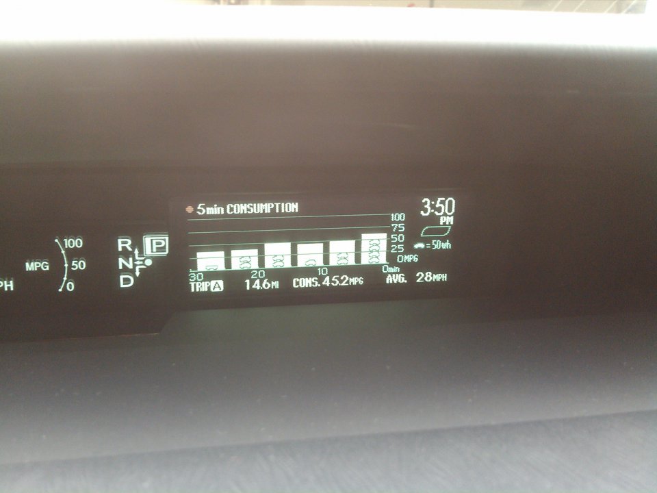

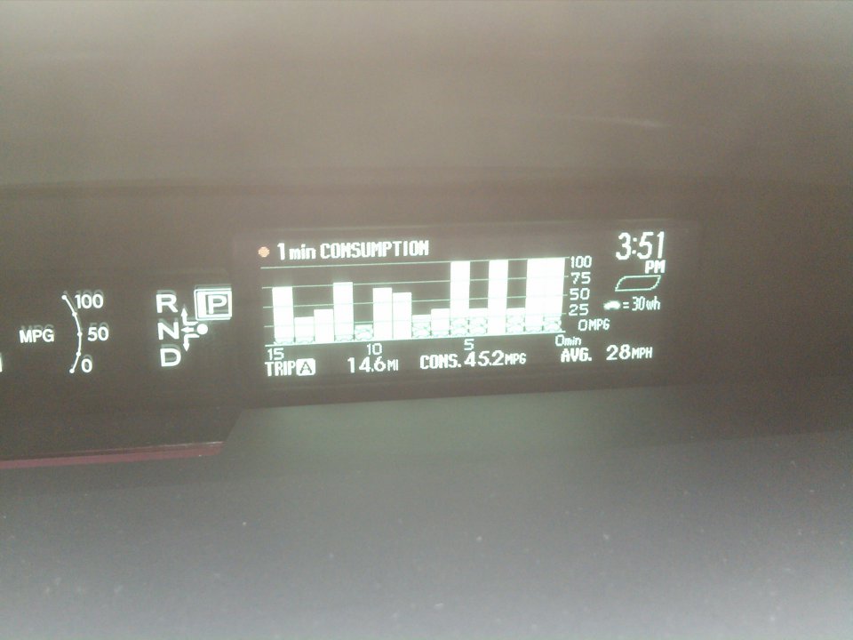

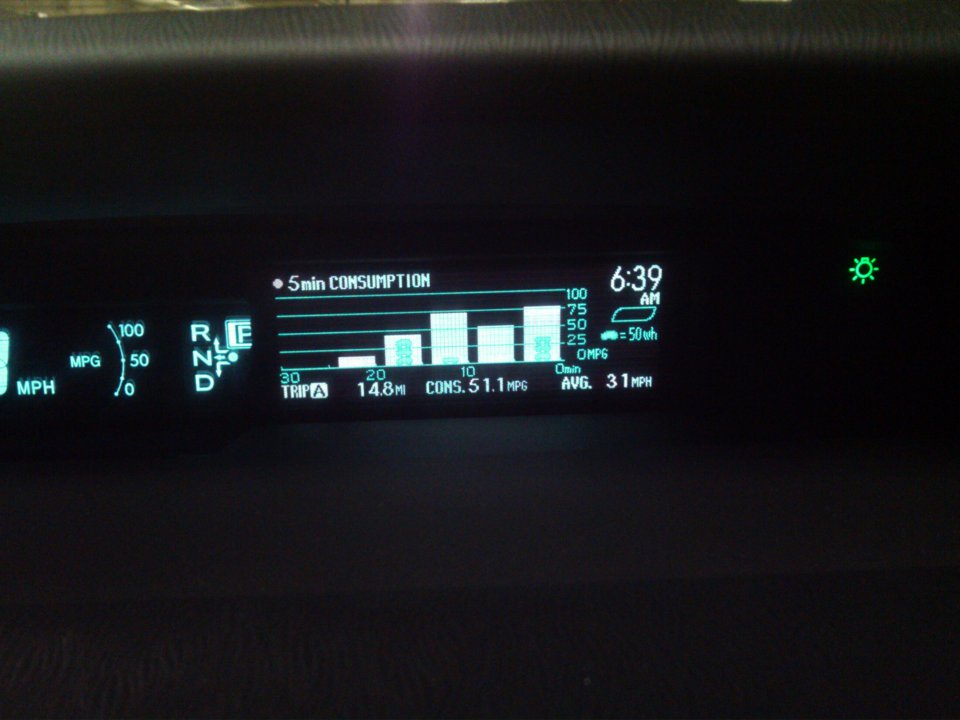

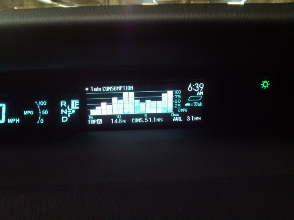

    here are pics of the fuel screen. the 630am is the drive to work, andthe 350pm is the trip home
    2014-01-28_15-50-54_993.jpg 2014-01-28_15-50-36_163.jpg 2014-01-28_06-39-39_977.jpg 2014-01-28_06-39-21_56.jpg
    outdoor temps were within 5 degrees AM-PM.. 18*F zero warm-up
    I took the same route each way, the only thing that accounts for the .2 mile difference is I have to go slightly past work and do a u turn to get in.
    did quick accel to get up to speed so I could glide more. on the way to work. out of the 1o traffic lights I think I only had to stop at 4 of them. Not so lucky on the way home.
