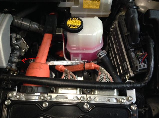

  6. Mendel Leisk
    61,397
    42,250
    I use a protruding bolt on the driver's side of the engine. Not sure what it is exactly, might be coolant bleed bolt?? For bigger clips this might not work, though.
    When we purchased the car needed a jumpstart and I watched the service department guy hook up there. Any bare metal on the engine is a really safe bet, most bare metal on the body also.
    If you've got a multimeter with continuity function (or just use ohms): hook onto a real solid bare metal on the engine, then check continuity to other prospective points you're thinking to use, make sure it makes a circuit.

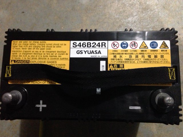

  9. Mendel Leisk
    61,397
    42,250
    When the battery's in the car there's a pretty obvious red cap with embossed + symbol. But take the battery out and it's a bit more subtle. I took mine out about a week back, cleaned the posts and clamps, then charged it at room temp. On the top of the case are just these embossed symbols, a little hard to see. I touched them up with a silver sharpie.
