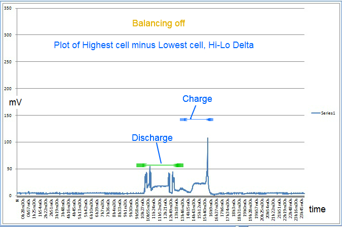

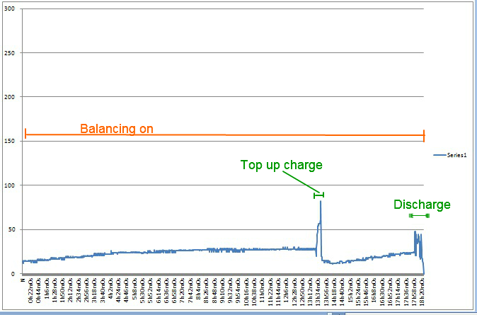

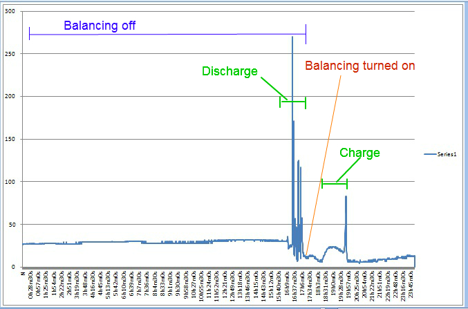

    Here are some MD-Tech BMS v1.0 readings. The High cell to Low cell difference, Hi-Lo has been plotted directly from raw data from the BMS files. They show quite nicely how tight the voltages are kept. The balancing trigger starts when the Hi-Lo cell difference is greater than 0.01V (10mV). It then balances to within 5mV. There is an accuracy error of 2mV in the BMS readings, this accuracy has been validated independently using a TCE instruments voltmeter.
    Diagram 1 - Balancing off (default) discharge and charge
    Diagram 2 - Balancing off until time 17.11
    Diagram 3 - Balancing on, top up charge and discharge
    The pack used in these tests was previously out of balance from using an Enginer 4.0.1 BMS. Cell 1 was looking weak hitting HVC and LVC before other cells. This problem seems to have disappeared using an MD-Tech BMS V1.0. The performance of the pack with a weak cell has been improved by leaving balancing on.
