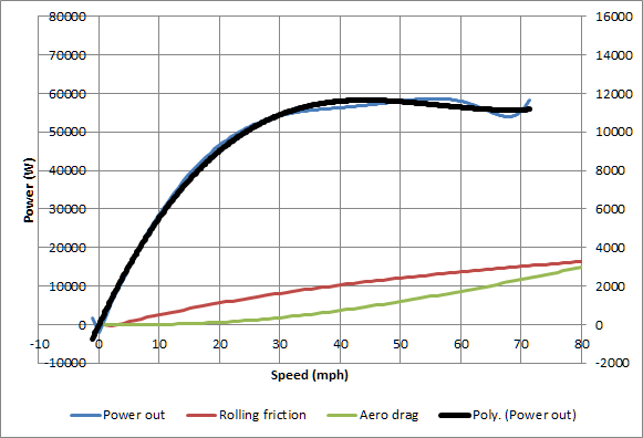

    The acceleration measurements so far provided seem to indicate that dual-motor mode doesn't work as the actual power to the wheels never exceeds the rating of MG2.

  9. Lee Jay

  10. bwilson4web

    That posting predates my interest in the Prime so I hadn't seen it. I'll see if I can get some dry pavement, standard day metrics.

    That would be helpful, but the car wasn't having traction problems when the power limitation occurred.
    To make sure I understand, at 40 mph, you're seeing about 59000 W. Based upon mass and acceleration, right?

    55,000W (the polynomial makes it look a little larger) and the latest version of this chart (which has better estimates for aero drag, and which I don't have handy) has it at about 53,000W. According to Toyota's written specs for dual-motor mode, it should be 68kW, and according to the specs for the individual motors and the words of the chief engineer, it should be 76kW.

    @Lee Jay , I wonder if a slight slope up of the track (say 1%) will make a dent in the calculations?

    First, I carefully verified where he was and determined thr slope was very nearly zero in both cases. Second, it would take more than 1% to make this change. Third, others have come up with similar times to this test.
