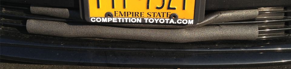

    Basically, by blocking the lower grill of your car, the air will not cool down the ICE as much letting the engine get up to operating temperature quicker, helping you get better mpg.
    Check out this thread:
    2010 Prius Grill Blocking strategy | PriusChat
    Here is my post:
    I just simply cut the pipe insulation to length and cut vertical slits to match the vertical fins of the grill. Then I inserted the pipe insulation around the horizontal fin of the grill. No need for zip ties, tape, velcro, etc.
    I have had mine on now for about 3 weeks, since the morning temps have been getting down to the low 40s on some occasions. It's been getting up to about 70* during the day. When I monitor the water temp with my Ultra Gauge it goes to about 200*. It definitely helps my engine warm up quicker and somewhat maintain my mileage as the weather changes.

    I don't know that I would endorse radiator blocking. It's not a diesel and doesn't move so much air thru the engine that it cools itself at idle like a diesel does. I understand the concept - to reduce air thru the radiator thereby keeping the water warm - however .. i see 2 problems with this. one - the engine has a thermostat .. it's a valve controlled by a wax pellet inside a closed vessel. when the wax heats and melts - it expands, opens the valve - let's the water go to the radiator... when it's too cool - it shuts, and doesn't allow flow to radiator. so - blocking the radiator doesn't really do anything if the engine isn't up to temp in the first place.... two - blocking the radiator in the city - could potentially cause the engine to overheat - as you are not moving - therefore not moving enough air across the radiator to keep the engine from getting too hot. yes it has an electric fan, but if you block the air flow - it can still overheat. i see this as a warranty voider and potential damage to your ice. i wouldn't recommend it-
    it has the recirc valve to help it warm up faster - it has i believe a thermus resovior to keep water warm to help it warm up faster - and it has a thermostat as a standard car does to control water flow thru the radiator - all of which are designed to get the engine up to temp (usually 185-195 degrees f) in order to keep emissions low and have the greatest fuel economy... altering that - just doesn't make sense to me.
    my 2 cents

    ^ No thermos on 3r gen. There is an accelerated warm-up strategy though: coolant is warmed by exhaust gasses.
    I've had no overheating issues. I keep my blocking on the conservative side, and monitor with ScanGage. A 50% block of the lower grill opening is something you can do without risk of overheating, anytime the temps staying at or below 15C (60~F).
    Last weekend I kept an eye the ScanGage on extended in-town driving, never saw coolant temps abouve 175 deg F. And this is with ambient temps hovering around 15C. This has me thinking to increase the lower grill blocking, even with these balmy temps.
