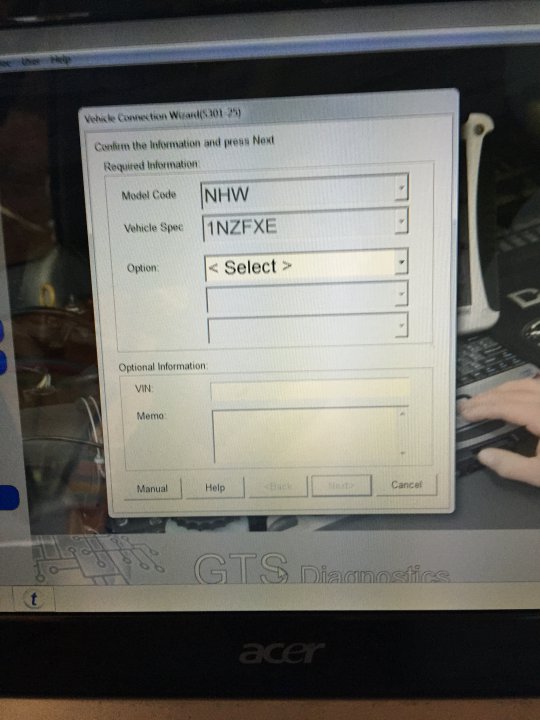

    My question is with windows 64 bit installation...With techstream open,to connect to prius i have only one choice. i have to "auto vehicle select", "manual select" is in code. I selected English for language through the entire setup process. i was wondering if the problem is with the device driver firmware? Some people have reported that updating firmware on this “cheap clone” cable may render it dead. So, the Firmware Update Tool should NOT be used for anything, but checking that the device is connected and working properly.
    The manual vehicle connection wizard shows for prius (model code "NHW") and (vehicle spec "1NZFXE")
    hopefully there is a techstream computer expert that can help?

    This is normal... after the connection is confirmed the software identifies the car and provides that information.
    Is that not the car that you are connected to?

    installed on a windows xp machine model code reads toyota and vehicle spec prius.
    installed on a windows 7 64bit model code reads NHW and vehicle sped 1NZFXE
    ps on a windows xp machine the vin# is automatically detected and entered under optional information.

    What car are you connecting it to?

    No... I mean what car are you trying to connect to?
    Your status does not identify the car you have and I didn't see where you identified the vehicle you are working on.
    No disrespect... It may be obvious to others but I honestly do not understand the problem you're having.
    Is the problem you can't get to the next screen where you can select the various test?
    When I first received my interface I missed a few steps in the registry settings and had to go back and review the configuration stuff.
    Once I got that corrected... it worked. Perhaps you are having a similar problem.
    Can you post some screen shots of the interface settings?
