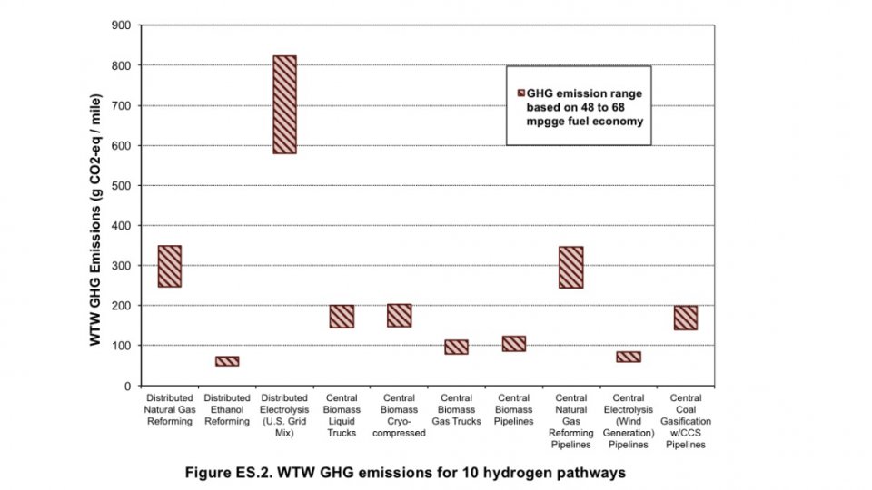

    I was referring to this chart from NREL report that Jeff N posted.

    The comparison in the chart is between coal with carbon capture and natural gas without. No reason why CCS couldn't be applied to NG reformation besides cost.

    That reference (which I do not like since the first time I saw it) seems to however agree with me
