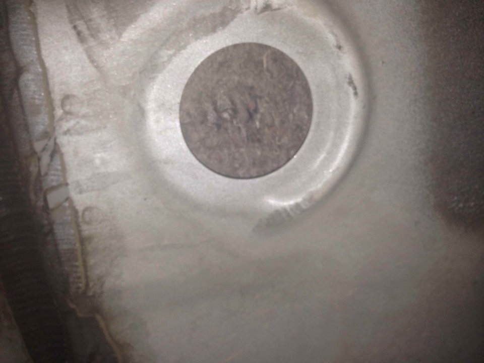

    Dear Folks,
    I found these two rubber caps(2 pieces) missing under the chasis during an oil change in the center of Prius alpha, the carpet is visible
    Can some one describe it to me what are these for?
    regards

    If that is a photo taken from under your car, that means they did not install the proper rubber grommets from inside the vehicle during assembly in the Trim area prior to installing your carpet. These holes are necessary during the painting process to allow the ED phosphate to drain when they prep the vehicle bodies for receiving the paint as they enter and exit large tanks. Depending upon where the two rubber caps are missing, it may be fairly easy for you to install yourself. I would show it to the dealer and tell them it was a manufacturing defect that these were not installed.
    Good luck. Let us know how it works out.

    If you obtain the right rubber plugs, you might be able to fold and squeeze them into position from below the car without disturbing the carpet at all. It won't be totally easy because the tops are the wide parts, but they are somewhat flexible and if you can do it, and make sure the bottom lip is even all the way around, you'll be done in 5 minutes.

    I'm not so sure they wouldn't stay put even if you put them in upside down from the bottom. In any case there are a number of available options for hole-plugs, a internet search should reveal quite a few.

    The cap plugs are installed from the bottom; NOT from the top under the carpet. So, there is no need to disconnect the battery. Although that won't hurt anything.

    The plugs are installed from underneath the vehicle

    The fact that there is an indented flange around the hole recessed upward into the metal explains it. That's to allow for the larger outer flange of the plug.

    Thank you folks , ill try from the bottom up first , you made it easy for me .
