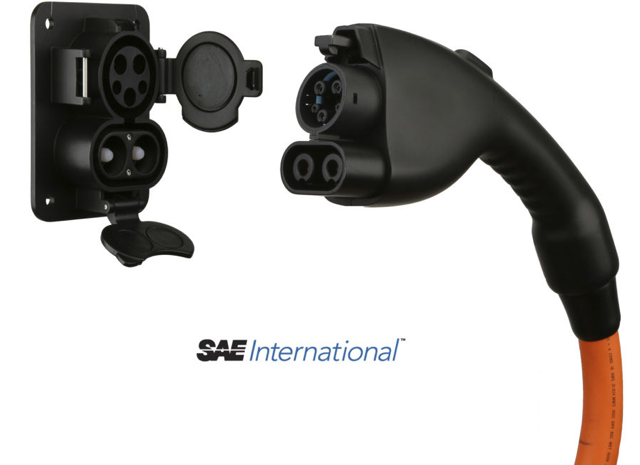

    I must say the SAE plug has several advantages over the chademo one. First, there is just one extended plug instead of two, and these share communications. The SAE fast charger also provides 90KW of charging as does the Tesla Supercharger, while Chademo only provides a maximum of 62.5 KW. The SAE also provides a little better fault detection.
    EV Fast Charging, whether standardized or not - Green Transportation
    SAE is far from perfect. It would be much better if DC fast charging was included in the J1772 standard, but they did not. It was tacked on with two extra wires. Still from a technical point of view, the SAE model is superior.

    The rub against SAE is they are being too slow, because GM is head of the committee. Well pull GM off, and put tesla, or NRG to head the committee, someone that is building cars or chargers, but lets not just throw up our hands. IMHO the two plug solution with what is it 10 things on the chademo looks like a huge kludge that we will be stuck with.

    While this is true, the idea of having 2 different plugs doesn't make a lot of sense to me. What if its a phev, that means 3 doors 2 for plugs and one for a tank. No 1 is better than 2. The frankenplug is ugly but so what. Nissan has already said they will make an adapter if the sae plug becomes standard. Why not allow 90kw, the normal ac plug allows 19.2kw, although nissan only allows 3.3kw to flow. There simply are only a few qc in america right now.
    1 plug means that the driver doesn't need to do anything different on DC charge versus AC.

    Its great that the leaf is going with 6kw chargers in 2013. Don't get me wrong, i like the leaf. Its much more affordable and practicle than the ev1. Naysayers are going to be naysayers. Because the utilities can make money on selling electricity in texas, they are all for the smart grid and 90kw chargers. The issue here is peak demand times 3pm-7pm during the summer, but no one expects enough evs to do much to hurt at this time. California is full of politicians on each side. I don't expect quick charging to be a big part of the grid, but if you are going to do it, why not make it 90kw, as tesla wants, versus the 62.5kw max. L2 standard is for 19.2kw, but ac charging at that rate makes more expensive equipment needed on the car. Tesla charges $1500 to go from 10kw to 20kw, and it may be less expensive to put the tech in dc chargers than in ac on the car.
    There are some states with very old grids, but really is there a L2 concern in california? The politicians better address that before paying for over 1M ev subsidies. I would say its not really a problem but a point that anti-ev folks use.
    Yes, its not harder to do 90kw correctly than 62.5kw. These things are expensive so why not do it right. I'm with chelsea sexton, that very few extra bevs will be sold because of 200 new quick chargers.
    California has always bothered me with their ev policy. If the politicians want evs, they need to regulate the utilities in such a way to make TOU easier and high pull at low demand cheaper to switch over from normal metering. Here we have smart grid, where I let the utility cut down my power during times of very high demand. California passed smart grid in 2009, but little of it has been built. Rates are high in California because regulators are regulating against building enough power. That is what led to the black outs.
    I would love it if someone would confirm. Nissan said that if franken plug passes, they would make an adapter from franken plug to chademo. NRG will likely try to support both plugs, as the base unit is the expensive thing. That is as long as not too many NRG quick chargers get out in the field before a standard is set, and now it looks like it will be much less than 100.
    I do like it that Mitsubishi was the one that proposed chademo to sae, not nissan. That at least did not make it a nissan against gm. The best solution is a plug from scratch like bmw is proposing, but they made it try to be compatible with franken plug. SAE is moving too slowly, that is the big problem with its proposal. 90kw is better. WIth a limited number of quick chargers wouldn't it be better to charge in 20 minutes than 30 minutes. The cost for DC chargers is not much greater for 90kw than 62.5. In fact, I would like it to be 100;-)
