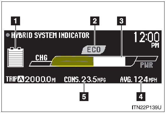

    Set your display to show Hybrid System Indicator screen. If the car's warmed, and you lift off the gas then gently re-apply while keeping the bar display to the left of the median (highlighted in yellow), you should stay in electric:
    Note, running in electric-only is one component of good mpg. But I wouldn't pursue it too aggressively, it becomes counterproductive if you run the battery down too much. Especially when the bar is nearly to the median, it eats the charge. Best to do that for short bursts only.

    He has a Gen II so that display doesn't apply and the operation of the software is also different.
