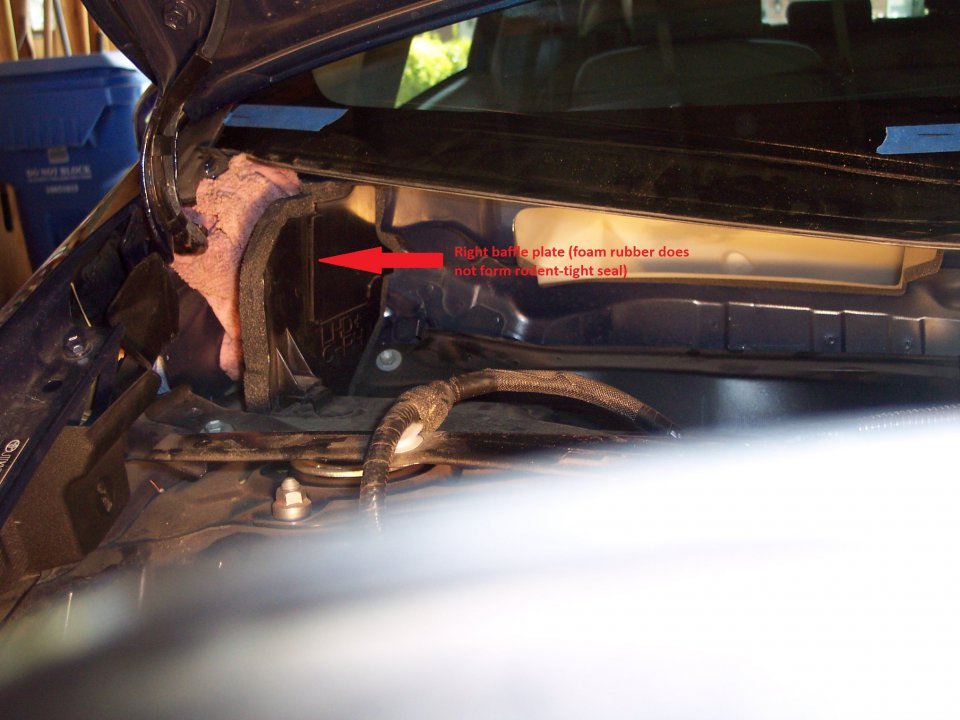

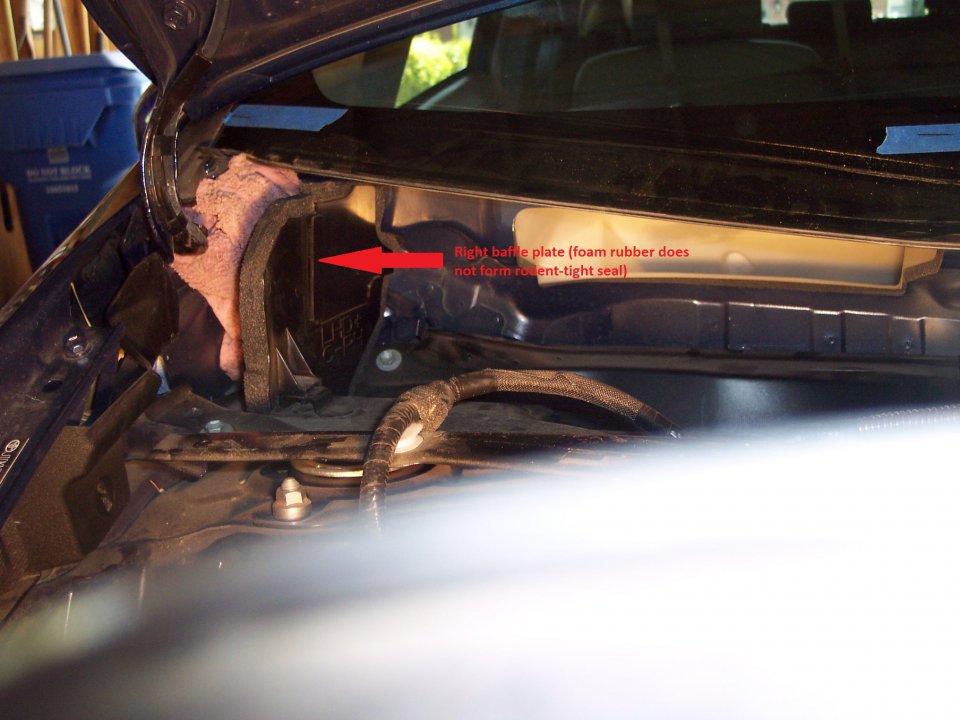

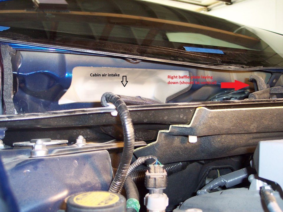

    Debris can build up under the cowl cover/mesh. This will rot (compost) and give you the moldy smell. To fix they must remove the wiper arms and a few other things before they can remove the cover and clean it properly, also accessing the air intake ducting. It should be about an hour labor. It could be covered by warranty, depending on how important customer satisfaction is to the dealer and to Toyota. If it was caused by leaves etc. then it would be the customers fault (parking where he/she shouldn't). It can also be caused by mice nesting in the car. That would be Toyota's fault, for not providing proper meshing to prevent them from getting in.
    Mice can also nest much further into the air system, and that will take much longer to fix.

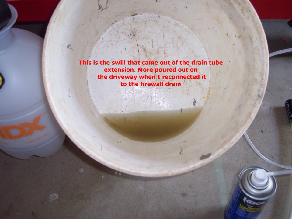

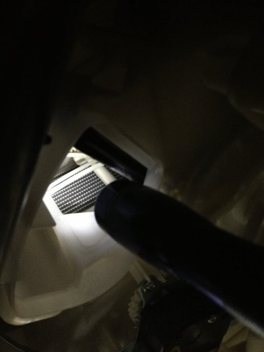

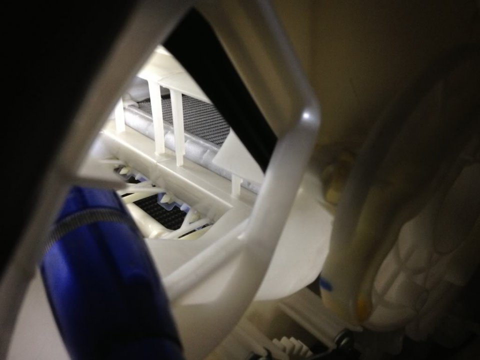

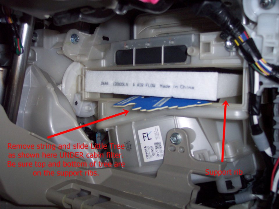

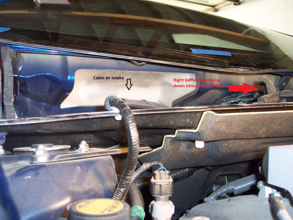

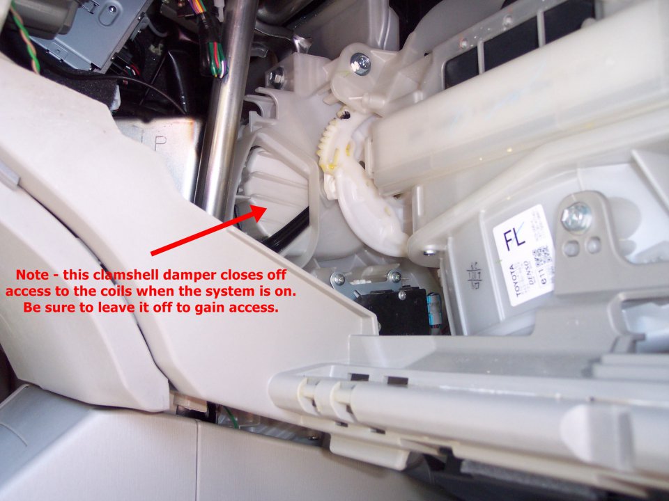

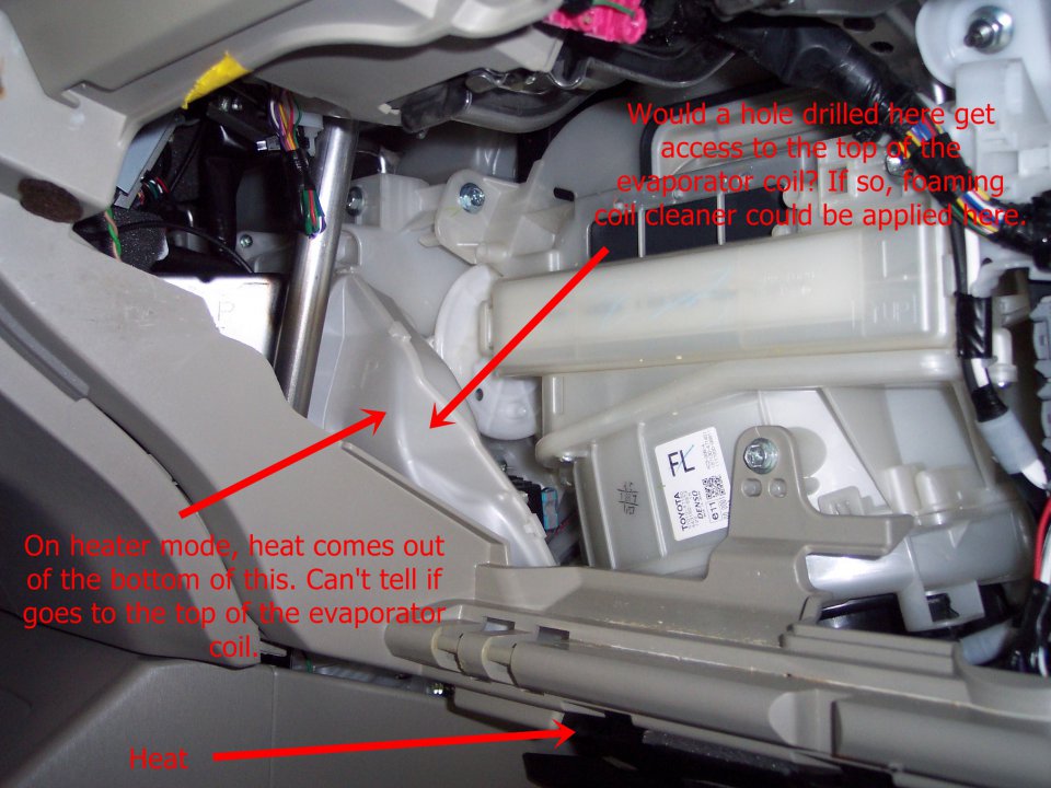

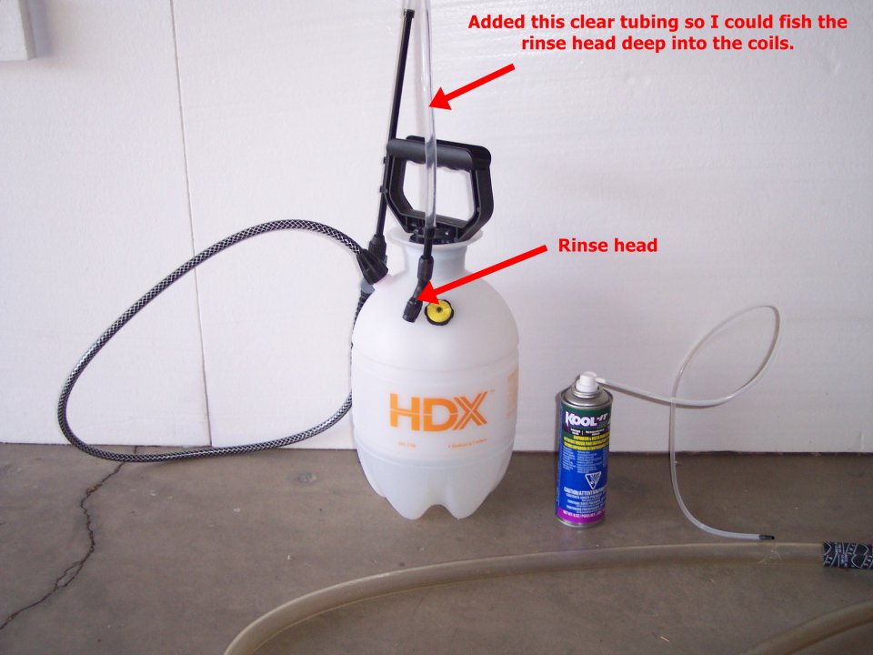

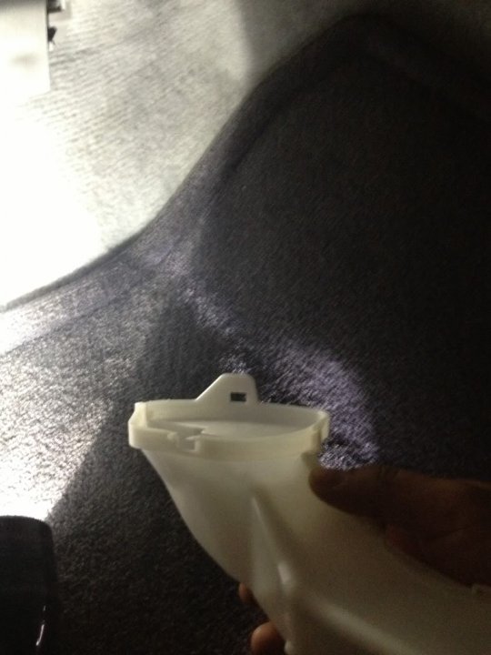

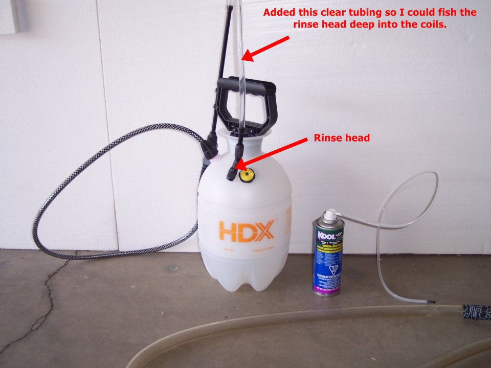

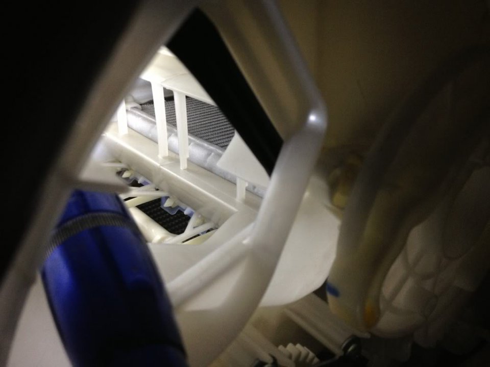

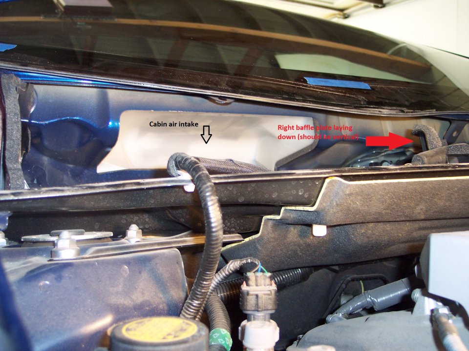

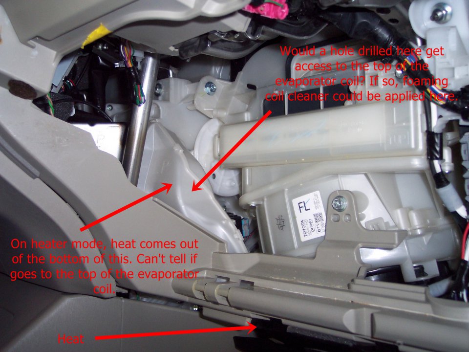

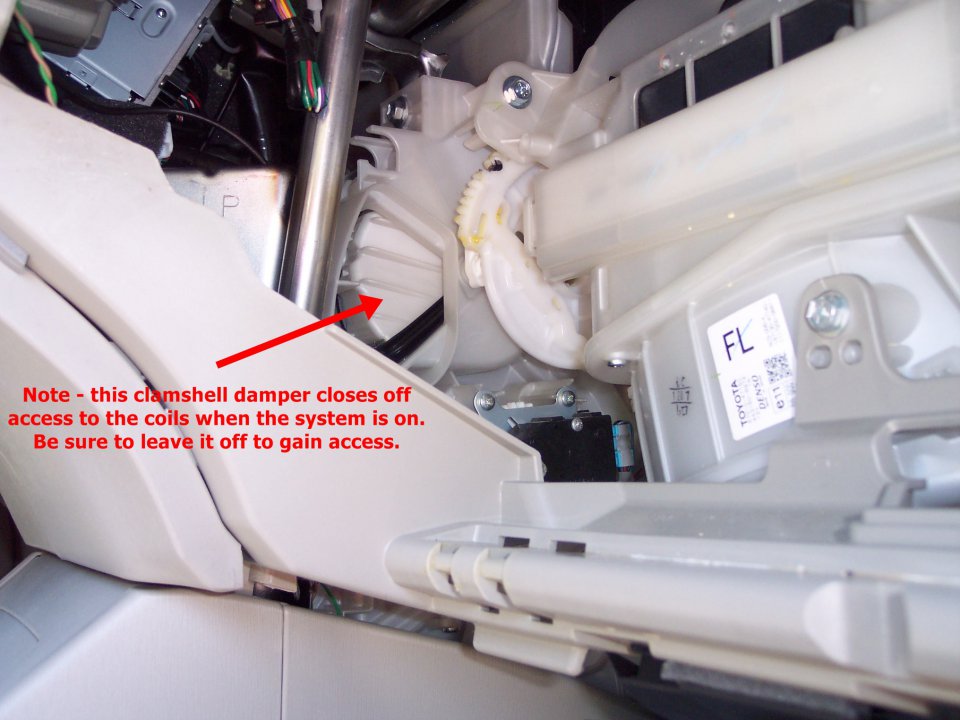

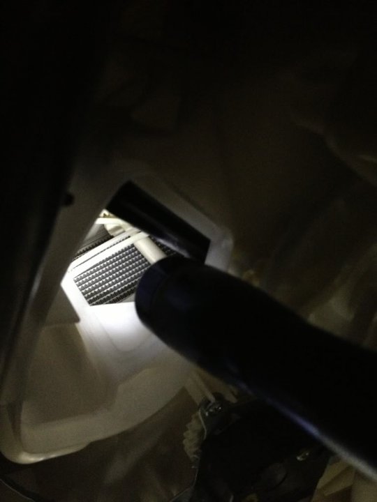

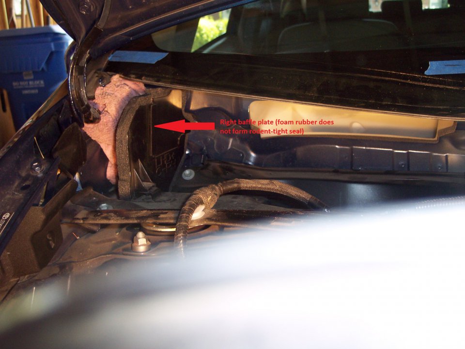

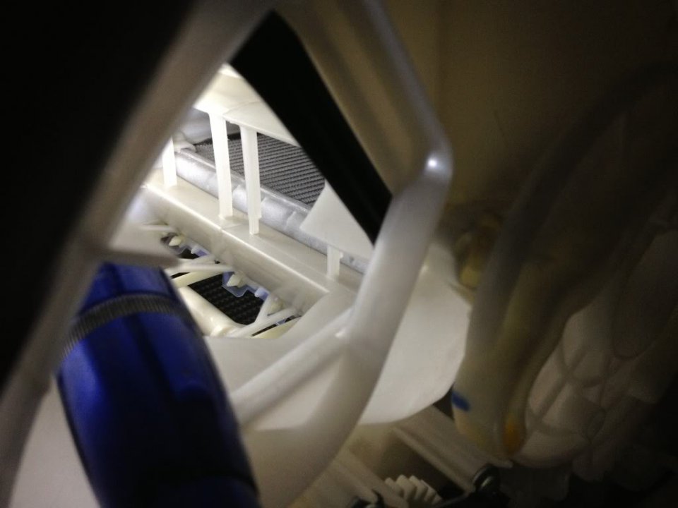

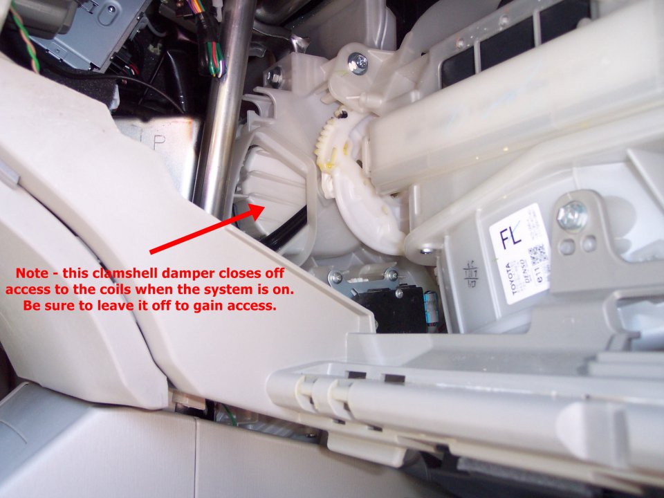

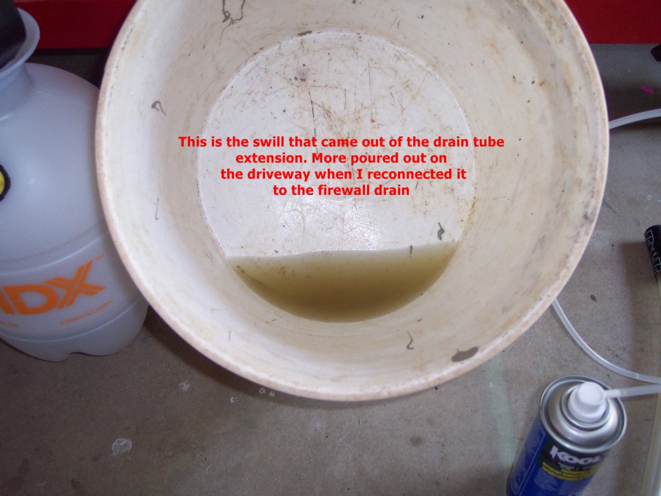

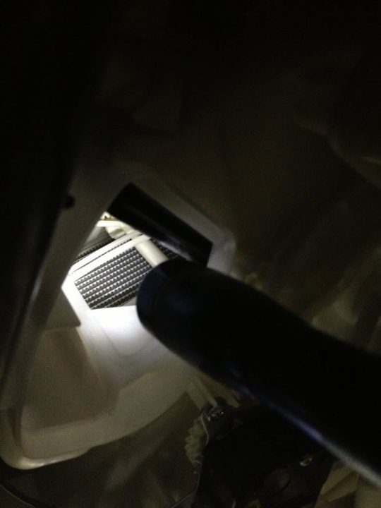

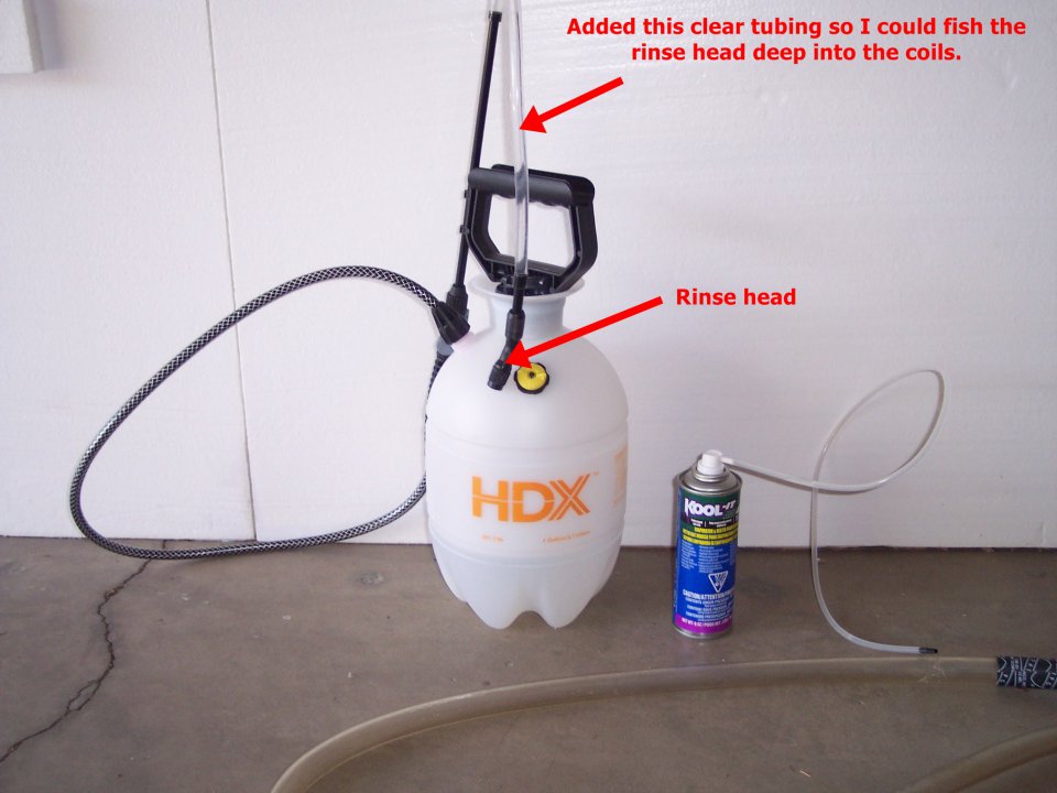

    First of all, you need to determine if the odor is truly coming from the AC vents, especially when the system starts up after sitting in the heat. If so, here are several pictures of how to cleanse the evaporator coils and how to get at the outer air intake in case there's something stuck inside of it:
    Wiper cowl area 001.JPG Wiper cowl area 002.JPG Kool It.JPG Fan and filter box 001.JPG Fan and filter box 002.JPG Fan and filter box 003.JPG Inside evaporator coil 01.jpg Inside evaporator coil 02.jpg passenger vent tube removed.jpg Evap coil cleaning 003.JPG Evap coil cleaning 001.JPG Evap coil cleaning 002.JPG
    Some of these pictures are courtesy of The Critic who discovered how to gain access to the evaporator coils from the passenger foot well. To remove the vent tube, take a very small screwdriver and insert it carefully along the top of the vent tube edge which faces the front console and slowly press downwards until the small clip is released. Then roll the vent tube towards the firewall and it will come free exposing the heater coil and the evaporator coil. Kool It is a product that can be applied to the upper and lower coils as a foam which should kill and release any mold build up on them. I also recommend a rinsing afterwards making sure the drain tube is working.

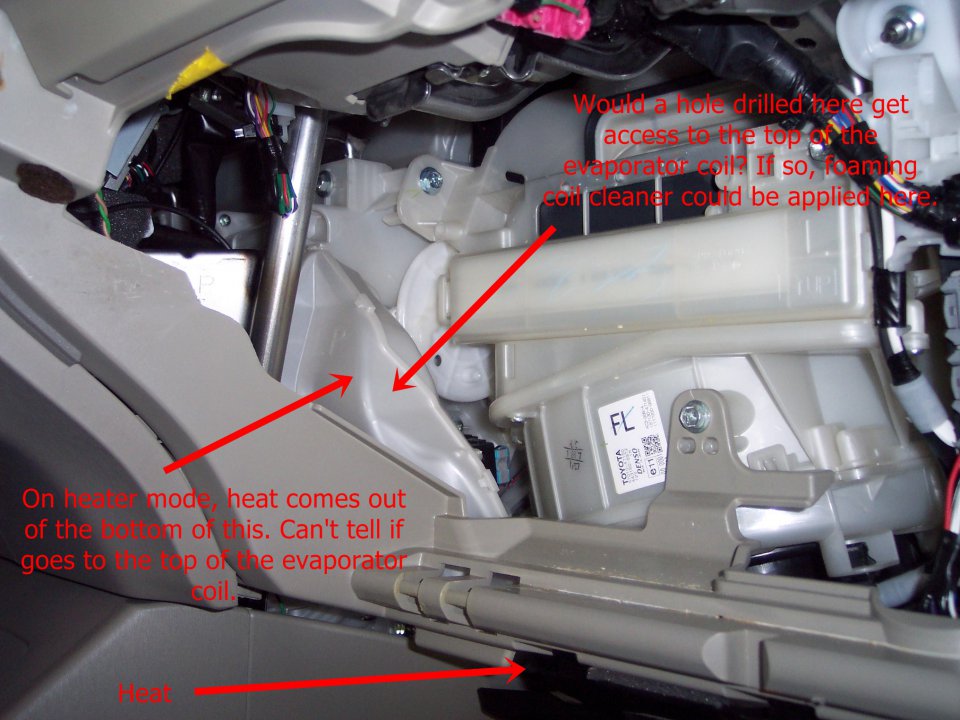

    Can you get to the coils without drilling ?
  11. phoenixgreg
    phoenixgreg Senior member
    Apr 7, 2010
    1,157
    295
    66
    Phoenix
    Yes - follow the last paragraph in italics that you quoted above. Once that white vent tube is released, you can see and access both the heater and evaporator coils. Another option is to pull back the upper left section of carpet in the passenger foot well to reveal the drain tube. You can pull apart the rubber hose piece from the plastic piece and inject Kool-IT coil cleaner directly in the base of the evaporator chamber, which can get moldy.

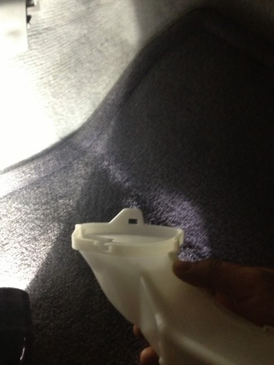

    The issue turned out to be that the fastener for the drain tube had failed and the a/c had a slow drain into the passenger footwell and then it molded. Dealer removed carpet and cleaned repeatedly, the smell still remained. The dealer used ozone to no avail. Ultimately I used Chlorine Dioxide - it is used to remove mold and musty smell from boats. There are several products available at marine or outdoor stores. Odor free in KC!

    But if the drainage condensate could not get out thru that tube, it may have also backed up into the evaporator chamber and developed mold up inside it too. Now that the drain is fixed, you might consider performing an evap chamber sanitizing using a product like Kool-it.
