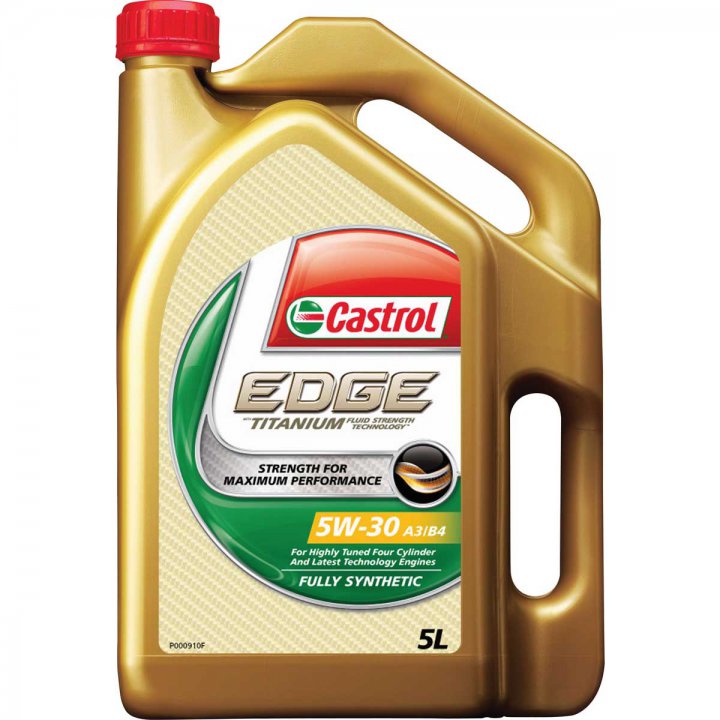

    @KiwiAl, you can spend quite a while agonising over the various (but limited) choices of oil here.
    I settled on Castrol Edge Fully Synthetic Engine Oil - 5W-30, 5 Litre which can be purchased from Repco when they run their discounts on oil. Recently you could pick up 5 litres for NZ$49.90.
    I have just used it for the first time and I'm on my second tank since service, so the jury is out for the time being as to whether it has made any difference. The first tank was good, but the second not so much. As everyone knows, there are so many variables, it is hard to attach any benefit to any one thing.
    Left to their own devices, dealers here will use 10W-40, which was used in my engine until now.

    Just seen that SuperCheap have a today and tomorrow only special on the above - limit of 2 per customer:
    Castrol Edge Engine Oil - 5W-30, 5 Litre
    Was: $85.88 each
    Now: $42.88 each ends 05/10/14

    I was just about to post that "heads up" here too. I picked up two of these today for the awesome price of $28 each. :) Good to see you getting a decent discount there in NZ too.
    This is the oil I've been using for a while now. SCA runs specials on it fairly often, so I stock up and usually get it for under $50. Today's price of $28 is the best yet though. :D
    I like this Edge 5w30 A3/B4 a lot more than the magnatec too. The A3/B4 euro rating is more about wear, deposits and stay in grade specs rather than a fuel economy. It's up toward the upper end (12 cSt and 3.5 HTHS minimum) of the 30 weight range, but I get very good fuel economy anyway, so that's a non issue to me.
    My opinion is that manufacturers can make lots of colourful claims about the wonders of their products, but industry specs like ACEA A3/B4, A5/B5, dexos etc are only passed by running stringent tests, so that's the only real thing I'm interested in when looking at oil. I couldn't care less about all the "true synthetic" vs "bogus synthetic" arguments, and whether it's made out of unicorn tears or grubby crude. I'm interested in the performance of the end product, not what it's starting raw materials are, and it's the well recognised and well tested industry specs that tell me this.
    That Castrol Edge 5w30 meets API SL, ACEA A3/A4, VW 502/505, MB 229.3/229.5 and BMW LL01. These are really good antiwear, deposit control and long life stay in grade specifications.
    The Magnatec 5w30 fuel saver however carries no industry specs other than the API SN and ILAC GF5. These are good fuel economy specs, but not nearly as demanding for wear etc as the Edge's specs.
