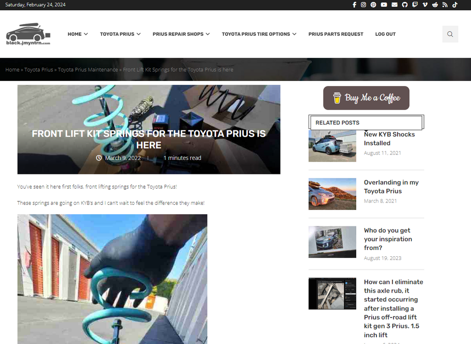

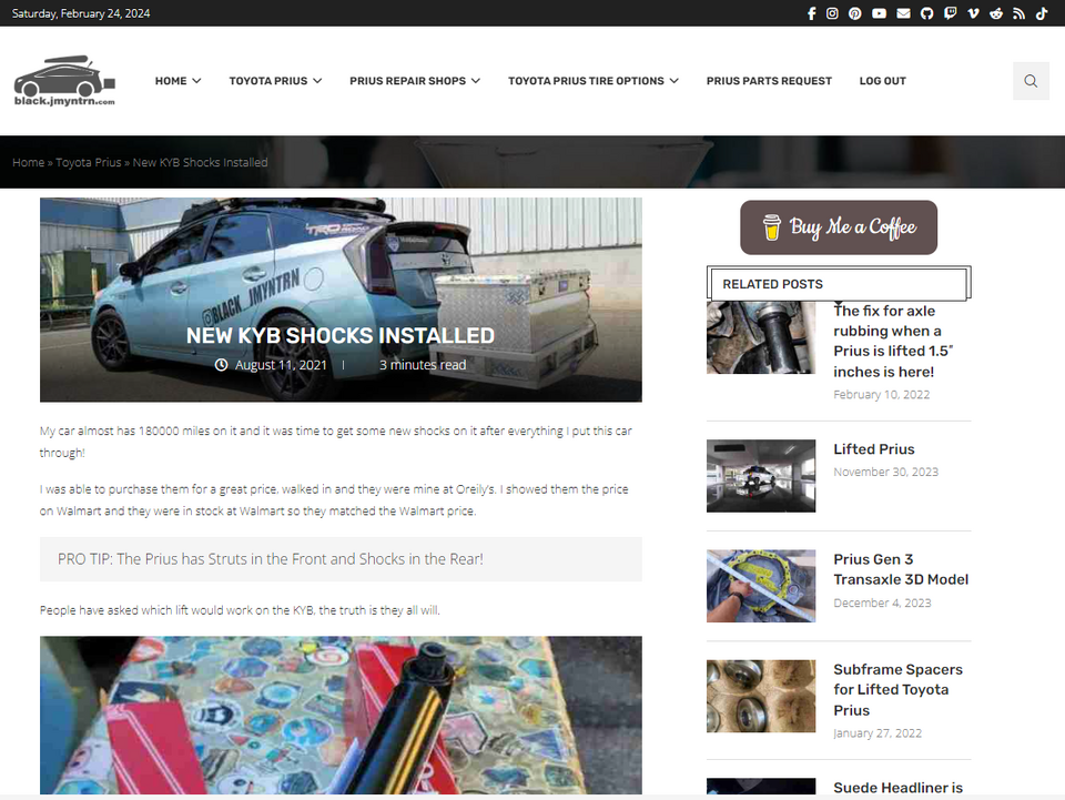

    there isnt much out there in terms of step up from typical unless you want to go lower or taller. both options a coilover system would be best with the springs all in one unit. I went with KYB front and rear with after-market lifting springs(the first Gen 3 ever with the springs in the front as well) on all four corners, with all terrain tires this thing doesn't break traction even in the rain... I've tried, multiple times and it just sticks!
    Initially, I only changed the rear springs with a set from an F-150 if not mistaken, I went through many sets of testing to find the more optimal setup for most users' usage plus those that like to get wild like myself.
    https://black.jmyntrn.com/2021/08/11/new-kyb-shocks-installed/?utm_source=PriusChat&utm_medium=weblinkt&utm_campaign=commentlink
    https://black.jmyntrn.com/2022/03/09/front-lift-kit-springs-for-the-toyota-prius-is-here/?utm_source=PriusChat&utm_medium=weblinkt&utm_campaign=commentlink
    but... next on the way you might be interested in... coilovers but ones that lift the car some if you feeling frisky! or.. you can leave it at stock height with improved components.
