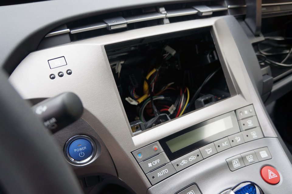

    1. Remove old stereo (make sure you set all your radio stations because you can still listen top the radio using the steering control) and remove the the faceplate.
    2. Drill new holes on the brackets(to move the stock radio and 1/4" further back).

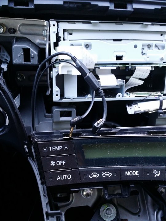

    3. Move the bluetooth antenna to gain more clearance
    4. Re-install stock radio back in
    5. Mount the tablet to the Alpine dash kit. I used JB weld Epoxy and some perforated metal strips that i bought at Home Depot.

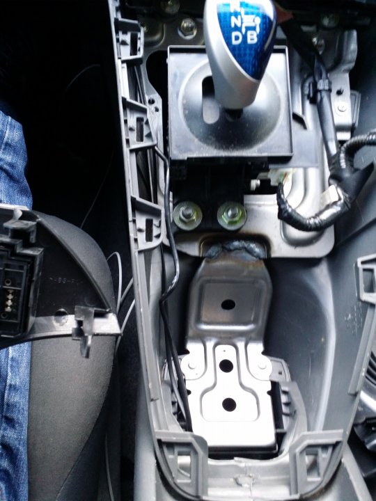

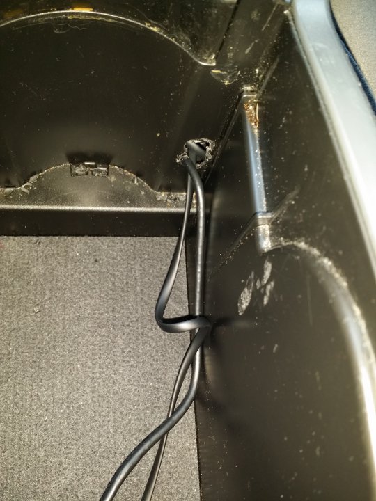

    6. Ran the wires (micro usb and aux cables)to the armrest
    7. plug everything in and you're done

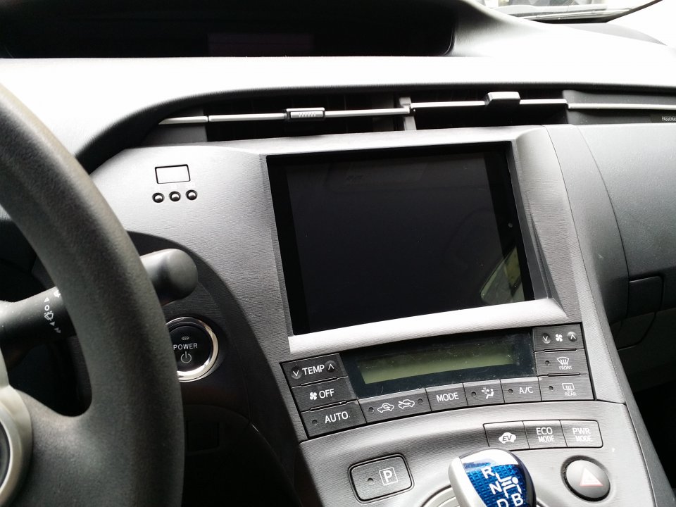

    Awesome thank you! But what is your regular dash display telling you in the green square box just right of your R/N/D?
  11. xcuter
    xcuter Active Member
    Apr 27, 2013
    303
    182
    oil maintenance required. lazy to turn it off.
