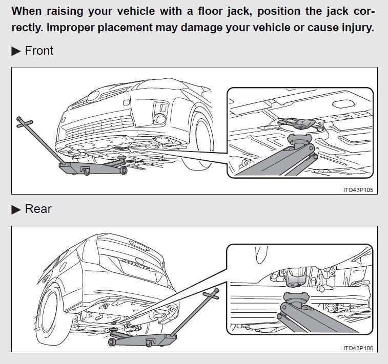

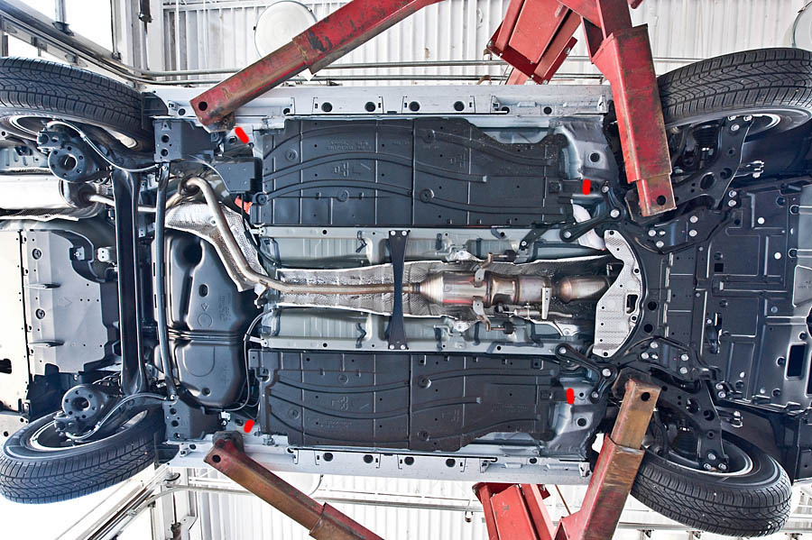

  12. Mendel Leisk
    61,307
    42,179
    I'm using a very ordinary 3 ton jack, not low profile. It fits under the front bumper ok, no problems reaching to the front-center jacking point. Maybe just roll the front tires onto pieces of 2x8, for a bit more lift?
    You need a 14 face socket, 64 mm face-to-face is ideal dimension. I use a Honda socket, works fine.
    My guess would be you've now got TWO washers on there: the one you added, plus the existing Toyota washer (which tends to glue itself to the underside of drain bolt. Should be ok for now. You can pick up the kosher washer at any Toyota dealership's parts department.
    There's a couple of ways I can think of. Maybe the safest is to roll the front onto ramps, then jack up the back (there's a rear-central jacking point) and settle it onto jack stands (at the scissor jack locations. Or you can raise the whole car and settle onto jackstands. I do the latter. I don't like the scissor jack points though, will post a pic of my choices. The car needs to be approximately level, just as long as you've got both ends raised roughly the same amount it's good.
    Front and rear centre jacking points (in owners manual):

    My alternative jackstand bearing points, alternatives to the scissor jack placement points, stronger, more stable:
