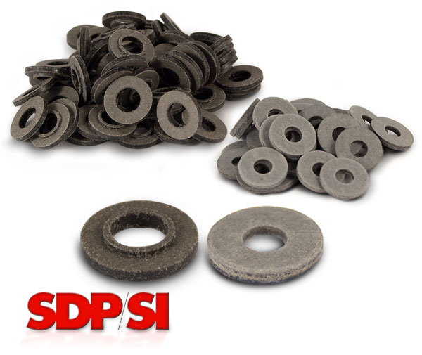

    I just got a call from Andrew with AIMS. He said the problem was a metal washer had been used rather than a nylon washer on a stand-off insulator screw close to the DC input on the inverter board. He said he found three metal washers had been used but only one was making a ground connection. So my unit should be on the way back tomorrow with the DC input isolated from case ground.
    The thing that ticks me off is that it sounds like it was one of the screws that I had loosened but did not completely remove to inspect the washer. I think I wiggled the screw around to see if I could get a change in the resistance but did not.
    Andrew said he would email me a picture of the screw and washer. I will post this once receive it.

    I'm not surprised it is a mounting issue causing it. A simple production mistake or wrong washer specified when going from prototype to production. I wonder if they would let me fix my own without voiding the warranty. This is simple mechanical assembly. My first job out of high school I built small production runs like this.

    16,156
    Metal screws or did the washer make the short to case by itself?
    I'm used to seeing insulating washers that have a raised inner rim and a wider flat. The inner rim holds the metal screw away from the center screw.
    Where their screws nylon?

    The screws were metal on both ends, from top side of board and underneath where it attaches to the case. I am used to seeing nylon screws used with nylon standoff insulators also.
    The washers were just small ones that were hidden by the screw heads. That is why I had a hard time telling whether they were nylon or metal without fully removing the screws
    bwilson4web likes this.

    The more that I think about this I remembered that they are not screws but metal threaded rods that are screwed in to the nylon insulator. Then there are nuts with washers that anchor the board to the nylon insulator. The washers are hidden underneath the nuts and are hard to see without removing the nuts completely.
    The ones that were easy to get to I remember removing the nut and checking the washers. All of the washers that I checked were nylon. The others that were not easy to get to I just loosened the nut to the top of the threaded rod and then tried wiggling the rod to see if I could see a change in resistance.
