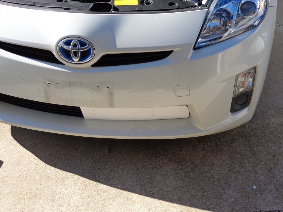

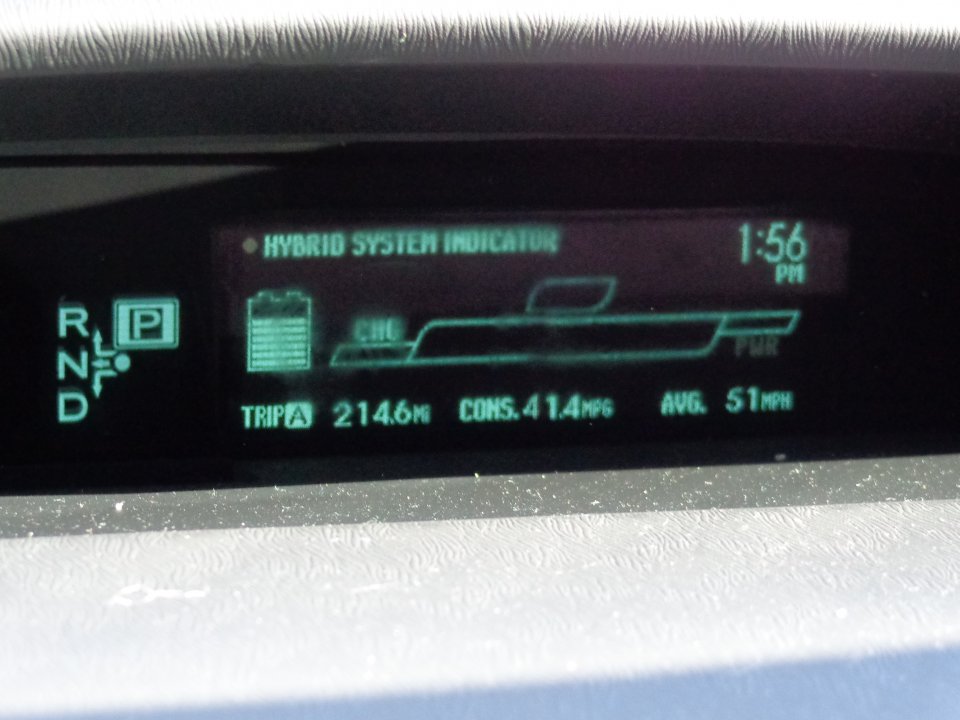

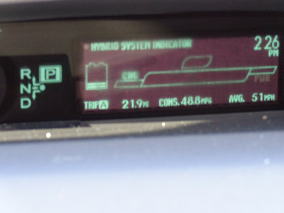

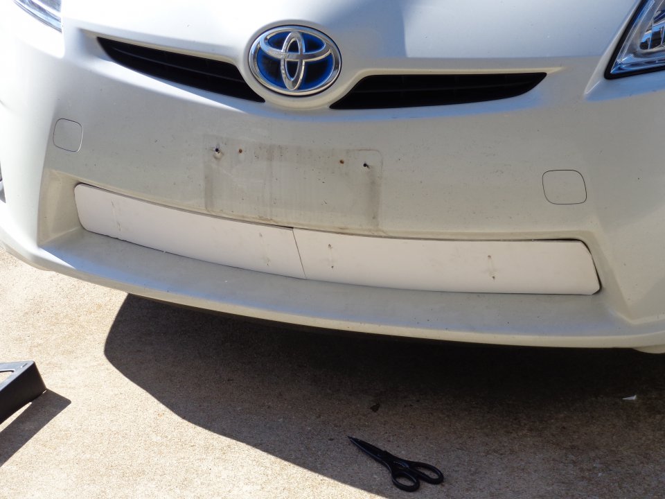

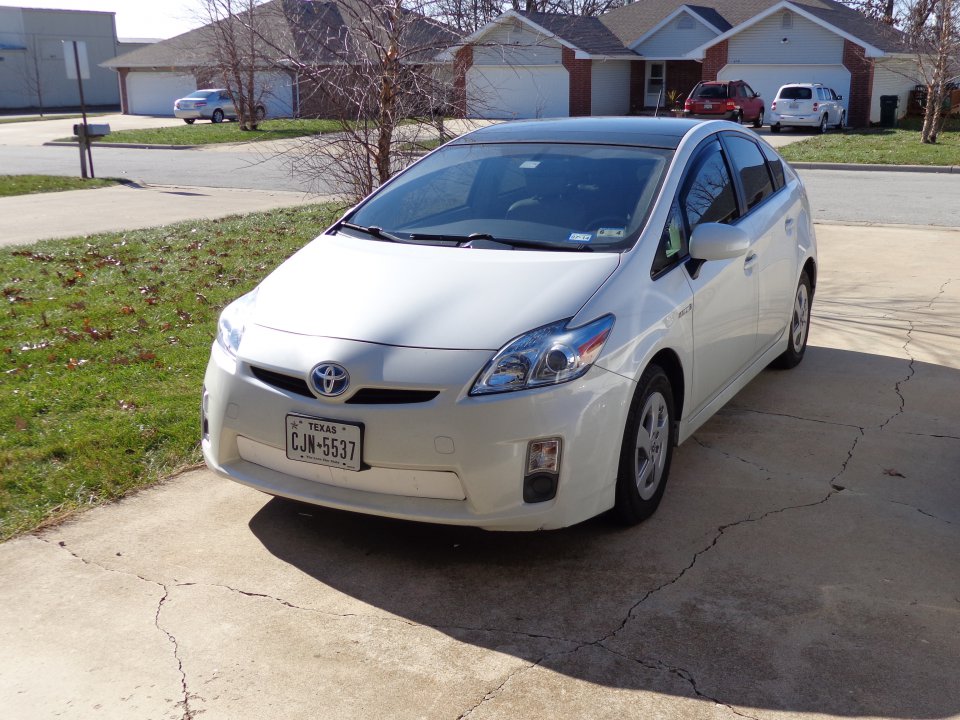

    I manage to find a PC to uplaod the pictures I took.
    Pic 1, before all the testing
    Pic 2, after full grill block
    Pic 3, half grill
    Pic 4 Full Grill Blocked
    Pic 5, Looks almost stock

    Parts,
    Foam paper $1.5
    White zip ties $1.8
    Time 15 min
    Not recomended for long usage, or water.
    This is my test set.
    If all works, I will upgrade to white board from hardware store for $8.00.
    Future upgrade plan is to motorize it if it all works.
