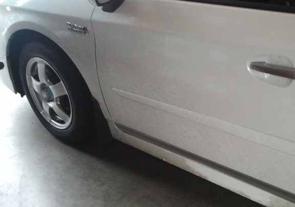

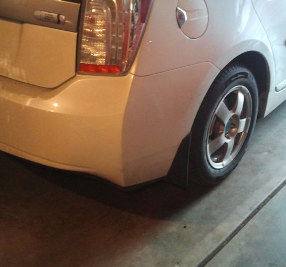

  13. Allannde
    Allannde Just a Senior
    Jan 7, 2006
    874
    138
    Washington State
    Okay!
    I finally got some photos to share. The Blizzard Pearl does not show real bad even when it is filthy. You may notice different wheels. I have my snow tires on. Notice how the black mud flaps just kind of melt into the tires? Here goes.
    Allan

  14. davekro
    davekro Member
    Oct 23, 2013
    493
    68
    SF Bay Area, East Bay
    2013 Prius Plug-in
    Allen,
    Very cool. Thanks for the pictures and a very Happy New Years to you!
