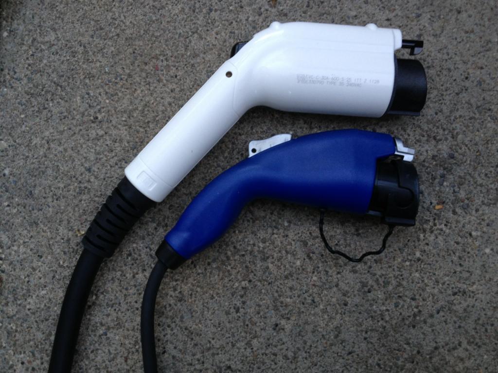

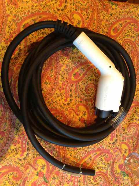

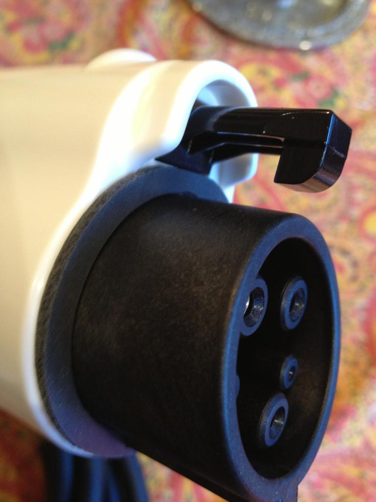

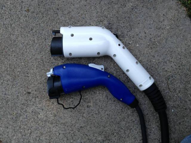

    I just received the Leviton 30A EVSE cable/plug combo. Here are my observations:
    1) The 30A-rated cable is VERY thick and heavy, as you can see in the photo below. Look where the white Leviton is laid next to the blue Toyota EVSE. If you're building only for PiP, the 15A-rated cable is the way to go.
    2) I plugged it into my PiP and the fit is very tight. It is difficult to remove from the car. I'm not sure where it's too tight, but I might try some fine sandpaper to loosen the fit.
    3) If you look at the close-up photo, note the thin foam o-ring. This doesn't seem very durable.
    4) The reverse side of the EVSE has a twelve screws. Not the most attractive.
    5) It feels solid and well-constructed.
    As long as I can solve the fit issue, I'll use it. Compared to everything else out there, the value is unbeatable, and from what I've heard of other cable/plugs that do-it-yourselfer's have bought, this one's probably the best.
