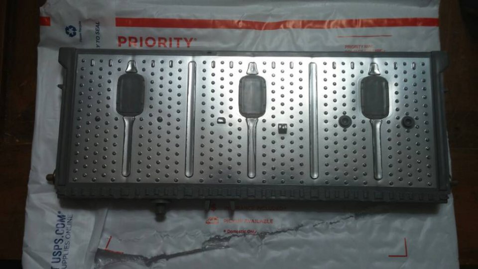

    After wondering what happend to my battery and finding out a major power cable was not plugged in, I have one dead module @6.47 on block 12 #24 and my replacement came today @7.90
