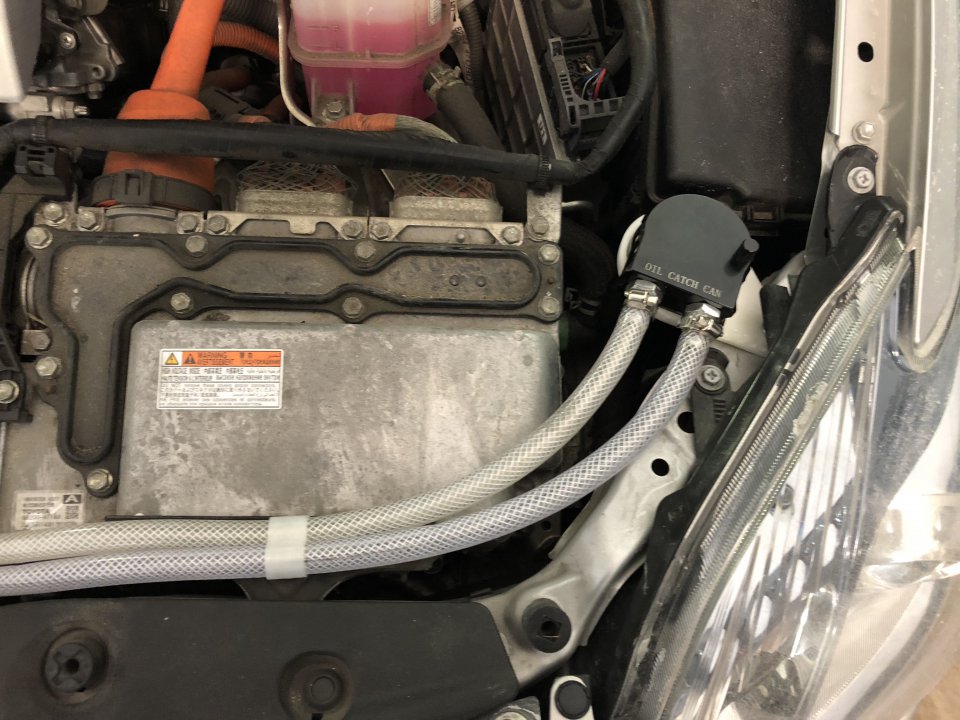

    I don't have mine mounted. It just hangs there. WorKS perfect. I'll send a pic later.
    It's rite by the headlight. Just swings back. Been there for 75,000 miles.

    Looks like it would rattle against the inverter or the frame above the headlight.
    Also, why is one hose clamped and the other hose not clamped?

    Never has rattled in 3 years and 85,000 miles
    Hose without clamp was super hard to push on........ didn't need a clamp.
    There is a clip on the can that rests on the front of the grill.
