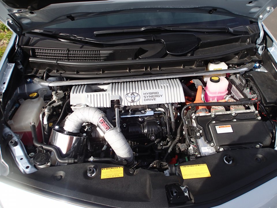

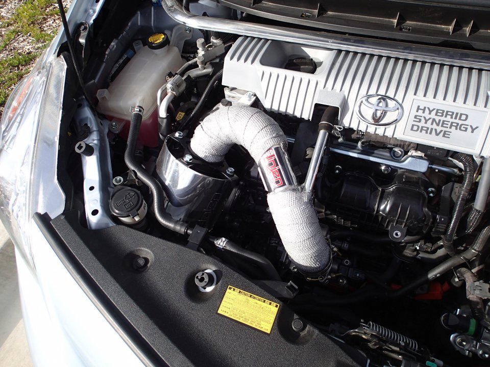

    Here are the photos of the INJEN cold air intake with stainless heat shield, including my Cusco strut tower bar. As mentioned in another post I lined the heat shield with Dynamat type sound deadener and it did cut down induction noise. My daughter, who disliked the noise, says it is now "...much more mellow."
    Except for the MAF attachment point, the entire CAI tube is wrapped with woven exhaust header wrapping and then painted over with silver exhaust paint. This is in attempt to keep the intake tube cooler.

    From the INJEN site in the section describing the benefits of their Prius CAI product: "Specifically built for radical top-end power gains in high-performance autos". For a Prius?
    My stock '12 v sucks air from the right side of the radiator where the air is cool.
    The stock air filter filters dirt out of the air by trapping it. Would a "reusable, high-performance cotton-gauze air filter with a built-in velocity stack" do this with the same effectiveness as the stock replaceable filters? I don't see INJEN providing any evidence of this. Most of the filters used in aftermarket CAIs, in independent tests I've seen, don't. More dirt and bigger particles aren't good for the engine.
    And generally, when you change the tune of a car, you give up something in one RPM range to gain something in another RPM range. The car makers seek a compromise based on the probable use of the vehicle. Tuners often try for the biggest HP, low end be darned.
    Citing a gain at MPH as opposed to a gain at a specific RPM isn't usual.
    Those who achieve results from their tuning generally post comparative dyno graphs so folks can see the effect on torque and HP over the entire range. Often the effective mods are numerous, involve intake, exhaust and ECU, and are very expensive per HP gained. With many false starts and replace this mod with that before they achieve the right balance.
    Your car, your money, your choice.

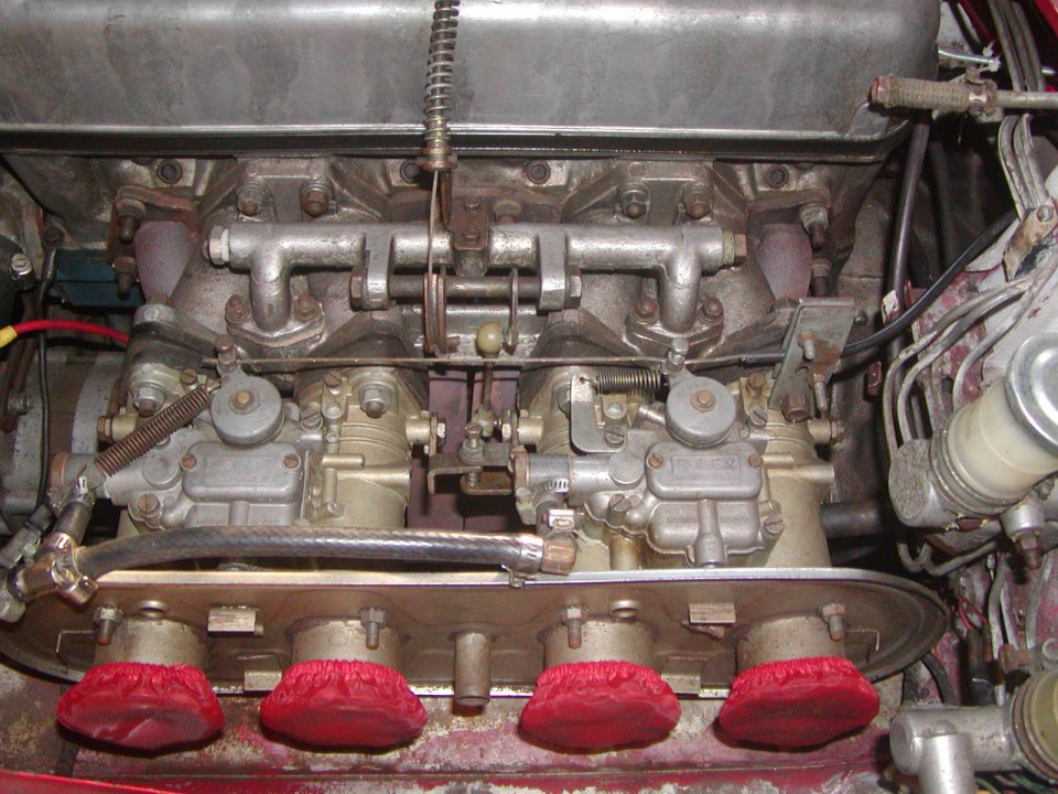

    Haha, the ONLY way to get a 10HP increase out of free-flowing air intake is to match it with corresponding cat-back exhaust modifications, and then likely re-calibrate the AFR with a dyno tune. The mods and pictures are cute, and likely to give a slight increase in mpg, but the other claims are mostly in your head. I ride a 100+ HP Harley-Davidson and have invested nearly 10K in the motor and 10.5:1 compression ratio, so I understand a little bit about horsepower gains.

    1. A petrol engine is basically an air pump. I agree that "air in must = air out" in terms of free flow. OTOH I think the current OEM Prius v (lowercase v for the Prius v wagon) exhaust can take a CAI in stride (i.e. accommodate a bit more exhaust flow) without needing modification.
    When I modded my '93 RX7 twin turbo on both ends I achieved a substantial horsepower gain (27 hp.). My tuned '95 Maxima gained 12 hp. AVERAGE from 2,500 RPM to 5,500 RPM.
    I may just do a dyno pull on the Prius and post the graph. Then we all can know.
