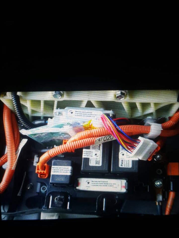

    Looks like AzusaPrius at least posted a photo a while back.
    and gave a description, in the same post, that could sound like it "will balance them better" (the modules), or could just mean it makes them look like "both at 16.50 each".
    @sworzeh, is this "Signal Soother" in your failed battery? Is it still in photographable condition? Could you attach photos?

  17. ChapmanF
    28,612
    18,947
    Yes, I can see that in the photo.
    That would depend entirely on the internals of the Signal Soother. There is nothing about that sense wire harness that limits the current that can flow through those wires (up to the ampacity limit of the wires themselves, of course). This lesson is occasionally driven home when a couple pins at the connector get shorted by corrosion.
    When it is plugged directly into the battery ECU the way God and Toyota intended, the currents that flow depend on how the battery ECU is built, and the ECU doesn't do anything but high-impedance voltage measurement. When plugged into a Signal Soother instead, that's going to determine what happens.
    I'm familiar with what the battery ECU does.
    I understand what you believe the Signal Soother does.
    It would be great to see some teardown photos with enough detail to decide if that's what I believe the Signal Soother does.
