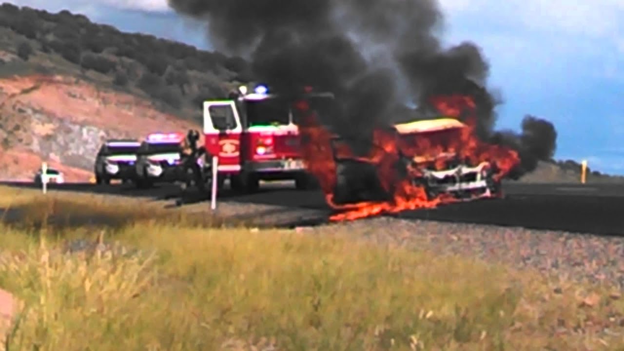

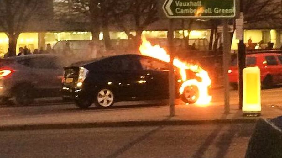

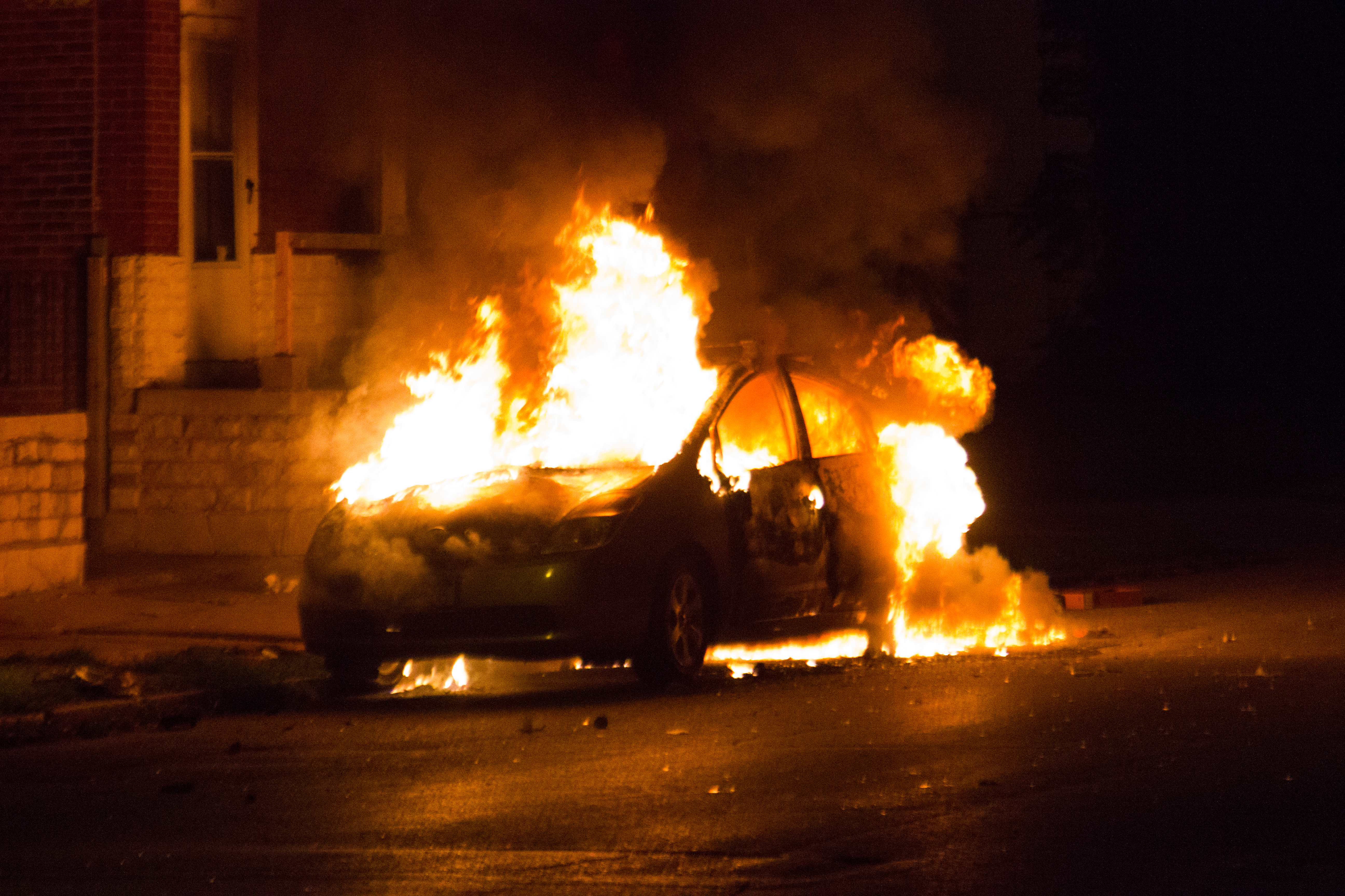

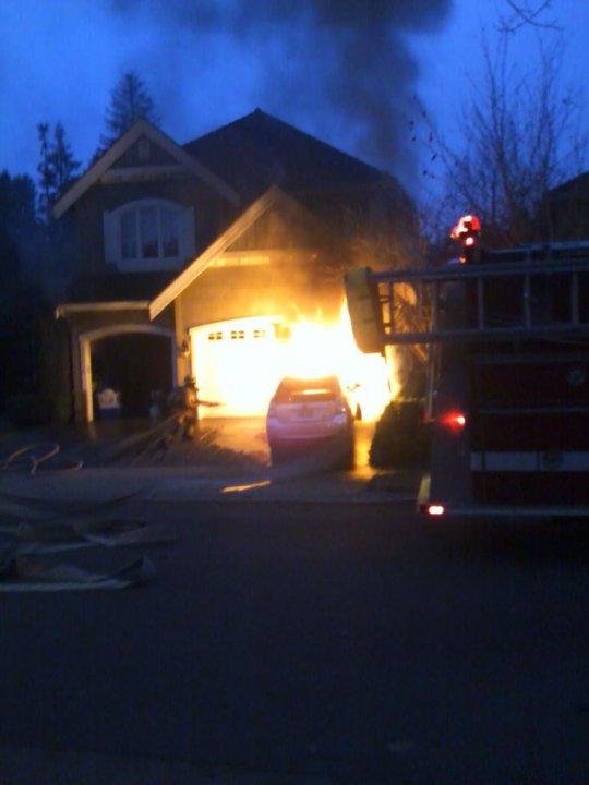

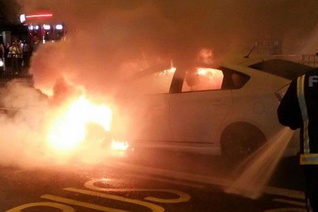

    Ok, I see 13 fire pictures here ... about six look to have an origin in the right front fender area, with the others either being hard to place, or definitely looking like the origin was somewhere else. The silver Gen 1 made me sad. Somebody remind me to go check my bus connections when the weather warms up.
    But I'm not sure what we learn just by stacking up pictures. Those 13 pictures show 0.00025% of Priuses sold. They look to have a few different points of fire origin. I think we would probably learn more by trying to group similar cases together and look for common elements.
    That was why I started the Gen 1 fires at ECU sense connector thread. It seems like maybe there's a feeling here that a Gen 3 fires originating near right fender thread would be worth starting, and then trying to collect technically useful information about them.
    I really wasn't kidding upthread about seeing if some Gen 3 owners could get thermal images of that area (baseline and periodically, before any trouble is suspected). Those imagers like the FLIR One are really cheap these days, and we might learn something.

    The first picture is from a tv show. They ran it out of oil and blew a hole in the block. And no it didn't catch on fire. That picture was just taken at the exact time it flung a rod.

    it's hard to make any generalizations beyond the facts that prius fires do happen and right front corner is a common fire site.
