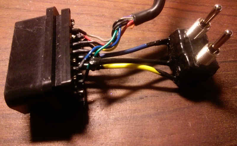

    Still looking. That Techstream utility even says straight out, "the TS pin will be grounded during this procedure", so last night I tried the resurrected TC/TS twiddler, but whatever Techstream is doing, it's more than simply grounding TS, because that didn't make the light go out.
    There are some procedures that involve pulses on TS. We know four pulses on TS will clear the ABS linear solenoid calibration (as I, ah, reconfirmed last night, then had to go through that calibration again :) ), or TS in combination with something else, but I still haven't found the magic twiddle for the TPMS signal check.
    Finally hauled out Techstream and ran the TPMS signal check utility again, and boink, the light went out. Now I don't get to try again until the next time it says the tires need air. I'd love to figure it out, because a twiddler is a lot less to carry around than a whole Techstream rig.
