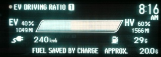

    My annual mileage is about 12,000 miles now. I used to do 30,000 before telecommuting. I only had my PiP for 79 days so let me do calculation based on that.
    My electricity rate: $0.22 per kWh (without the base service charge, 32 cents per kWh with it)
    My gasoline: $3.70 per gallon (I filled up in both NJ and NY)
    Adding 15% charging loss to 240 kWh = 276 kWh consumed from the wall. Electricity cost is $60.72.
    Gas cost is 29 gallons x $3.70 = $107.3.
    My total fuel cost = $168.02 so it came out to 6.43 cents per mile.
    If Voltdriver pays the same fuel prices as me, his cost per mile would be 6.94 cents per mile. Electricity would cost him $1,359.82 and $72.89 for gas for a total of $1,432.71.
