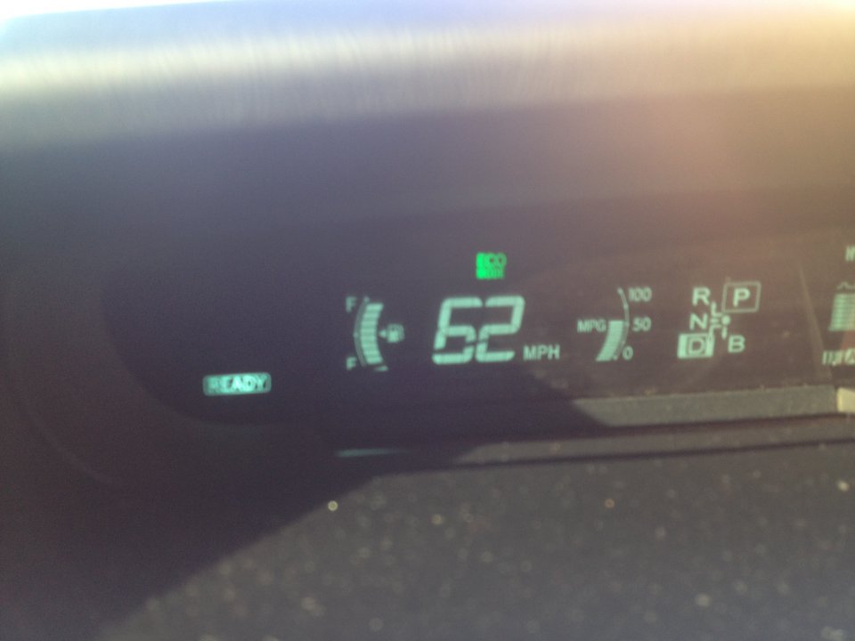

    Alright all you geniuses :), here is a pic. It's a needle; likely a temperature indicator for either the battery pack or the inverter - there are two of them. You can see it through the bottom of the 6 and the 2.

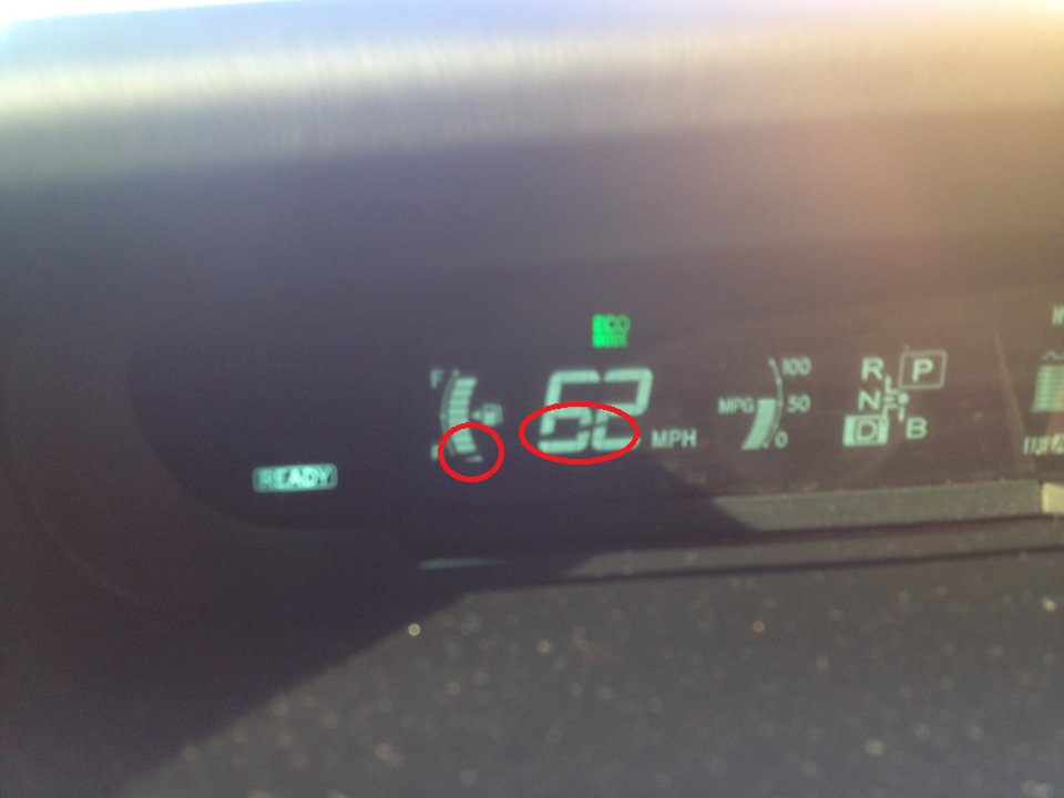

    temp needle2.jpg Are you talking about where I circled with red? That is very strange. Never seen that before. Looks like something got stuck in the LCD display

    That is not normal, if it is indeed what the OP is referring to.

    Wow, a picture is worth quite a bit here.
    What is pictured is not a normal part of the dash display.
    Not sure what is wrong, but you shouldn't have that "line" on your display.

    Bingo! Trust me, it's a needle. There is another one I've seen, to the right (obviously not visible at this time).
  14. Gracie Jiu-Jitsu
    Gracie Jiu-Jitsu New Member
    Nov 11, 2013
    Scottsdale, Az
    It took about 30 seconds to slowly go down and then disappear.

    All right. I see the "needle".
    This could be wrong, this could be right. The display is actually mirrored from a projector located in the dash. In terms of absolute direction, the projector shoots the image towards the front of the car, angled up somewhat; it then reflects off of something like a mirror and back towards the passenger compartment.What you actually see is the reflection of the projector, not the projector itself directly.
    Occasionally, people show up here claiming that their dash display has gone blank. It turns out that said people have lost a slip of paper or some such down into the crevasse where the projector sits; said piece of paper is not obviously in view, but does a handy job of blocking the projector down in there. One can sneak one's hand up into the crevasse area and feel said lost slips of paper, after which the paper can be slid out and the "help me! I'm blind!" reaction stopped.
    So I kind of wonder if you've got a piece of narrow garbage or some such down in there. Sticking a small brush down in there and gently wiping it back and forth might dislodge whatever-it-is without an expensive trip to the dealer. A small vacuum cleaner, or maybe one of those computer keyboard "blast it out with fast moving air" cans might also do the trick. Assuming my guess is correct.

    Negative. That's what I thought at first. As I stated in my earlier post, it rises like a needle, and sinks like a needle; slow and steady.

    Once in a while we in Prius Chat get a report of a defective display. I've got a 2010, it sure doesn't do what yours is doing. Admittedly, most of these reports involve:
    1. Scum forming over the screen. This seems to be associated with tropical, damp climates. (Most often)
    2. Screen flat-out disappearing. (Followed by an in-warranty trip to the dealer.)
    3. The aforementioned "garbage in the slot" problem. (Usually caused by putting too many papers on top of the dash, and something sliding forwards.)
    It'd be nice, and cheaper, if some form of #3 was your problem. It crosses my mind that that's an LCD display with a strong backlight down in that crevasse. LCDs run with relatively high voltage, which makes for static electricity, which is one of the reasons dust and grit tend to get attracted to your computer screen. So, if something came loose and is electrically attracted to that screen, then watching it wander up and down in response to the E-field might be possible. It'd be even more fun if it was inside of the glass protecting the front of the projector, in which case blasting away with with a can of air wouldn't do you much good.
    I've never contemplated getting the dash apart to the point where the display can be removed and inspected. I suspect it's not an easy job. If it's not the junk I suspect, then it's electronic in nature and probably requires a display replacement, which, by all accounts, is $$$. Heck, just getting the dealership (or whoever) to get the display out for inspection is probably $$, anyway.
    If the car is under some kind of Dealer's used-car warranty, I'd take it back and make snotty noises at them. It you bought the car as-is, what the heck, if it's not getting worse and you don't feel like spending something a bit short of half a grand to get it out of there, let it lie.
