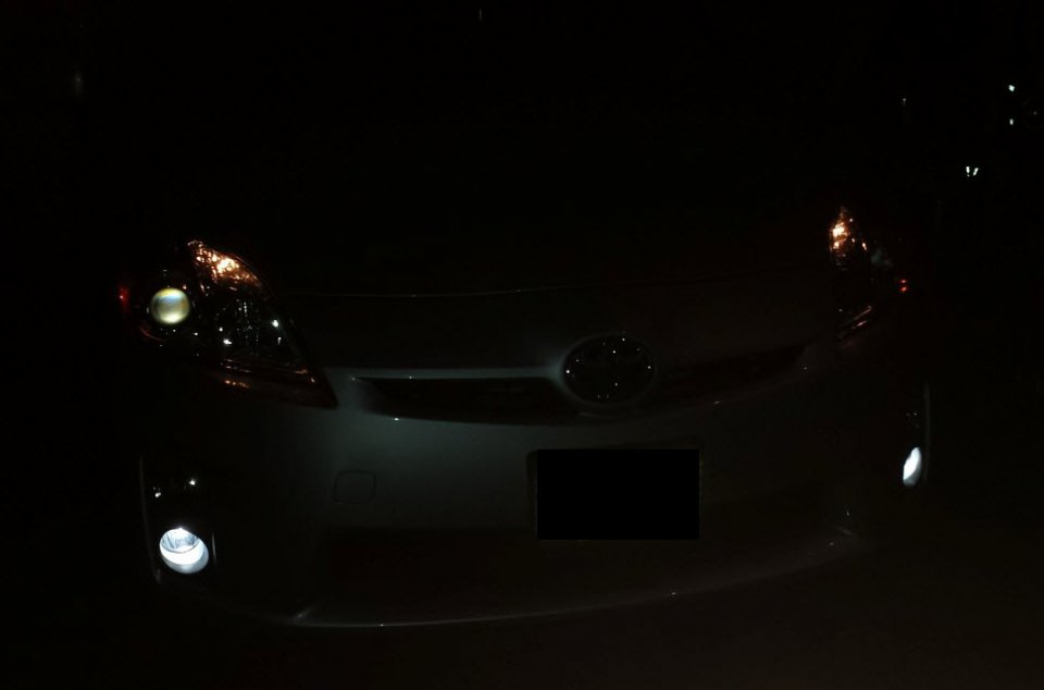

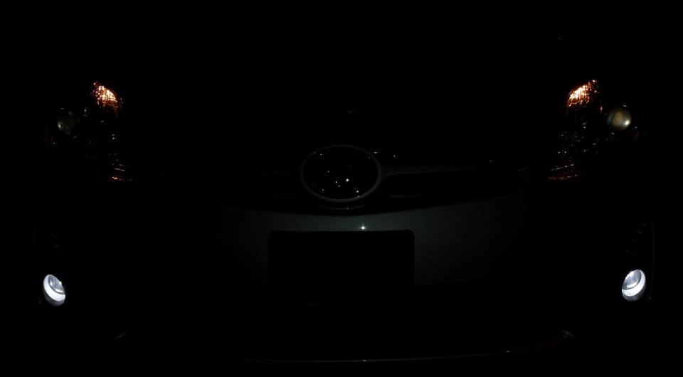

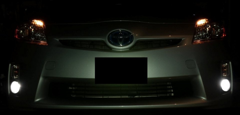

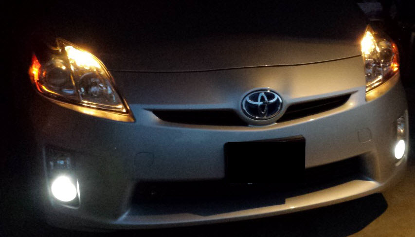

    Just did DRL's on my 2010 Prius and must say i am impressed! Since I never use the fog lights anyways and I was always wanting some "safety" lights these worked out like a champ! They do not provide much help on the road but they look cool and serve their purpose. Photos Attached.
    Bought these low wattage LED's. Important, if you buy these make sure you buy 4 of them. If one goes out your replacement down the road will likely be a slightly different color as the cheaper LED's are made in different batches.
    " " 20131005_190549 (Medium).jpg 20131005_190617 (Medium).jpg 20131005_190703 (Medium).jpg 20131005_190755 (Medium).jpg

    Please post pics of them in full sun, not night shots. ;)
    I bet the LEDs are pretty much useless during the day in full sun, which is when DRLs should be highly visible.
    I used modified 35w H8 halogen bulbs for my DRLs before doing my highbeam DRL mod and they are much more visible in full sun than using LED bulbs in the OEM foglights.

    I will try to get a couple day shots, when i was installing the fog housings in the day you could see the LED's no problem when I tested them. Granted they are not too bright but that is what I wanted. I think 35W is too much for DRL's. I also wanted something with very low draw as not to bring down my 12V batterying too much during my extremely long glide sessions :)
    I see your in Honolulu as well, here in the NW we see overcast clouding rainy weather all winter so these will add a little extra visibility when not running the headlamps.
