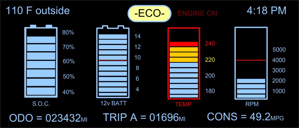

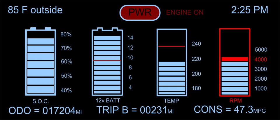

    What about something like this:
    #25 phoenixgreg, Oct 23, 2014
