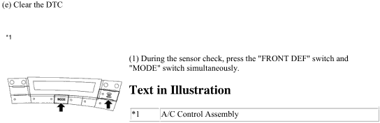

    Yup, that was probably it. The repair manual section for that code does say "the compressor operation remains stopped until both the history and the current DTCs are cleared."
    Out of curiosity, had you ever tried either using a scan tool to clear the HVAC codes, or using this DTC clear gesture while the panel diagnosis is showing?
    That might also have done the trick.
    As far as I remember, the only ECU in the car with codes that can only be cleared by pulling a fuse is the one that moves the parking pawl ... there's a list of eight codes for that one that can only be cleared by pulling the P CON MAIN fuse.

    Re: a scan tool, all I had was a simple OBD2 scanner and I don’t recall it being able to see the HVAC module. Thus, the only way I was seeing the HVAC code 72 was via the holding down of Recirc & Auto during start-up I need to consider something better going forward. Do you have a recommendation?
    Re: trying pressing Front Defrost and Mode simultaneously, I did read through that Repair Manual and saw that for the Prius it was Front Defrost and Mode - but it didn’t work for me and so I didn’t mention that. I probably should have (I’ll try and edit) as that is probably what triggered me to try pulling the fuse while the 12V battery was still attached.
