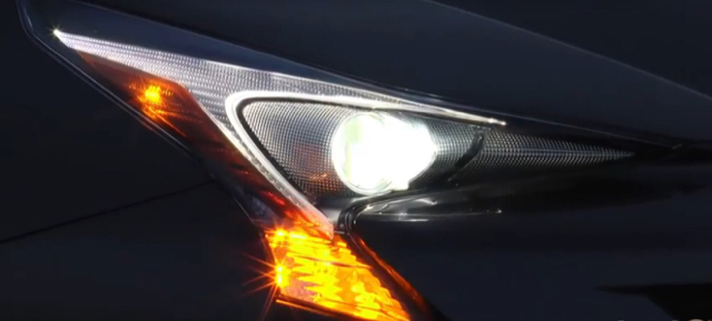

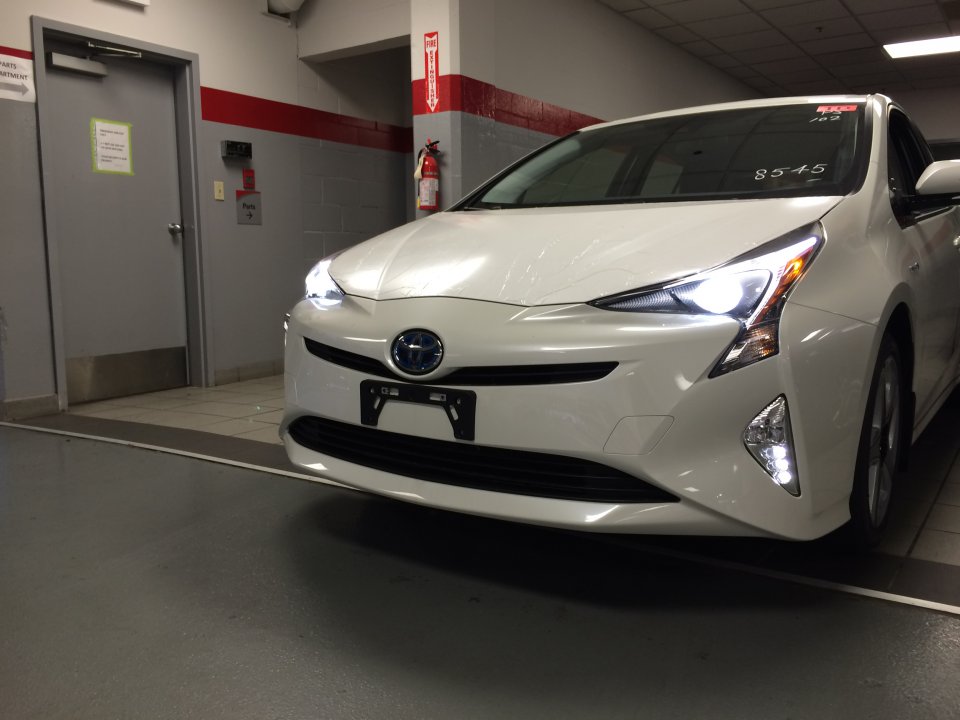

    The bright white LEDs are being used as daytime running lights, so they're on in any position other than DRL Off (this only applies to US cars, other markets mandate they be on at all times), when the vehicle is running. In Auto when it's dark, or in on, they go to full brightness. I don't recall seeing anything in Techstream about headlights (like disabling them in any position other than DRL Off) along those lines on my car, but maybe I missed it.
    In any case, parking lights exist so that you can have the vehicle illuminated when parking on an unlit street - they're relatively low power, so they're unlikely to drain the 12 volt battery overnight. However, in practice, with US reflector standards, this is rather unnecessary. And, if the manual's accurate, the lights will shut off after 20 minutes even in the parking light position.

    This morning, I drove around with the light switch set in "Parking Lights." (2nd position.) I had yellow lights up front, but the DRL's come on too. And the Z tail lights are on as well (which I like.)
    Parked for awhile, came back and powered up. I again turned the switch to "Parking Lights." But this time, there were NO DRL's, just the yellow lights up front, along with the Z tail lights. Why the difference this time?!
    Very strange. I had all yellow up front... I was "cool." :ROFLMAO:
    Switched everything off... Powered up again, turned on the Parking Lights, and the darn DRL's were on again! (along with the yellow lights and the Z tail lights.) Just another Prius oddity....
    (I also noticed that no lights work unless the Prius is powered up. Unlike a "normal" car, where you can turn the lights on any time.)

    No. The DRL's were definitely ON the first time I switched to Parking lights. But then they were OFF when I tried again later. Strange.
    I'm going to go into the "settings" menu on the big screen, and deactivate the DRL's. Then try the Parking Lights again and see if I get all "cool" yellow. :D

    Did you touch the parking brake? If you turn the car on while the parking brake is engaged, the DRL stays off. Once you disengage the parking brake, the DRLs come on.

    I drove around with just the FRONT YELLOW parking lights on, and the REAR RED "Z" tail lights. No DRL's.
    Went into the Vehicle Settings on the big screen, and temporarily deactivated the DRL's. (Just temporary guys... I'm not that "cool." :LOL:)

    Hey Pete; I shared your concern about the lights at first. My dark grey 2016 Prius III has all the bells and whistles. Having aircraft and water craft licenses, I am a fan of "BEING VISIBLE", day and night, under all conditions. ...especially in a craft as small as the Prius. For that reason, I like the low intensity headlight and the parking lights during daylight operation. Regarding your concern with the night-time operation of the full headlights, I was having the same problem with being "flashed" by oncoming night-time drivers. I experimented by setting the lowbeam direction adjustment "down one centimeter". In the past week, I've had no complaining oncoming drivers "flash me". It still provides me with superior forward visibility with the headlamp lowbeam. And my bright light setting will still burn the hair off of a varmint crossing the road.
