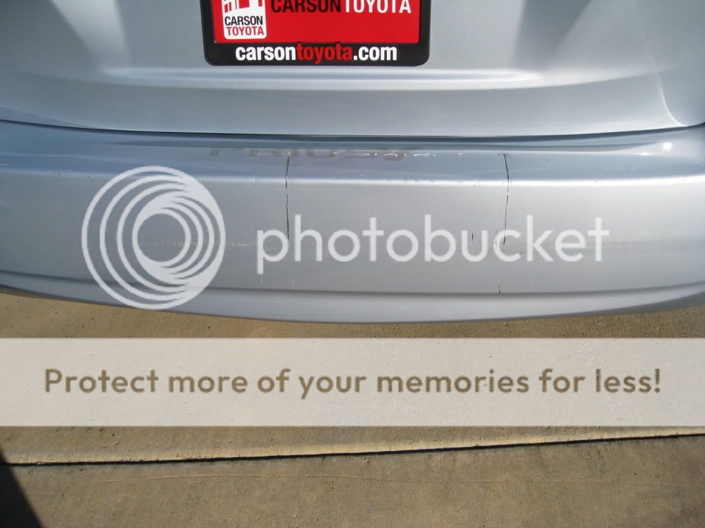

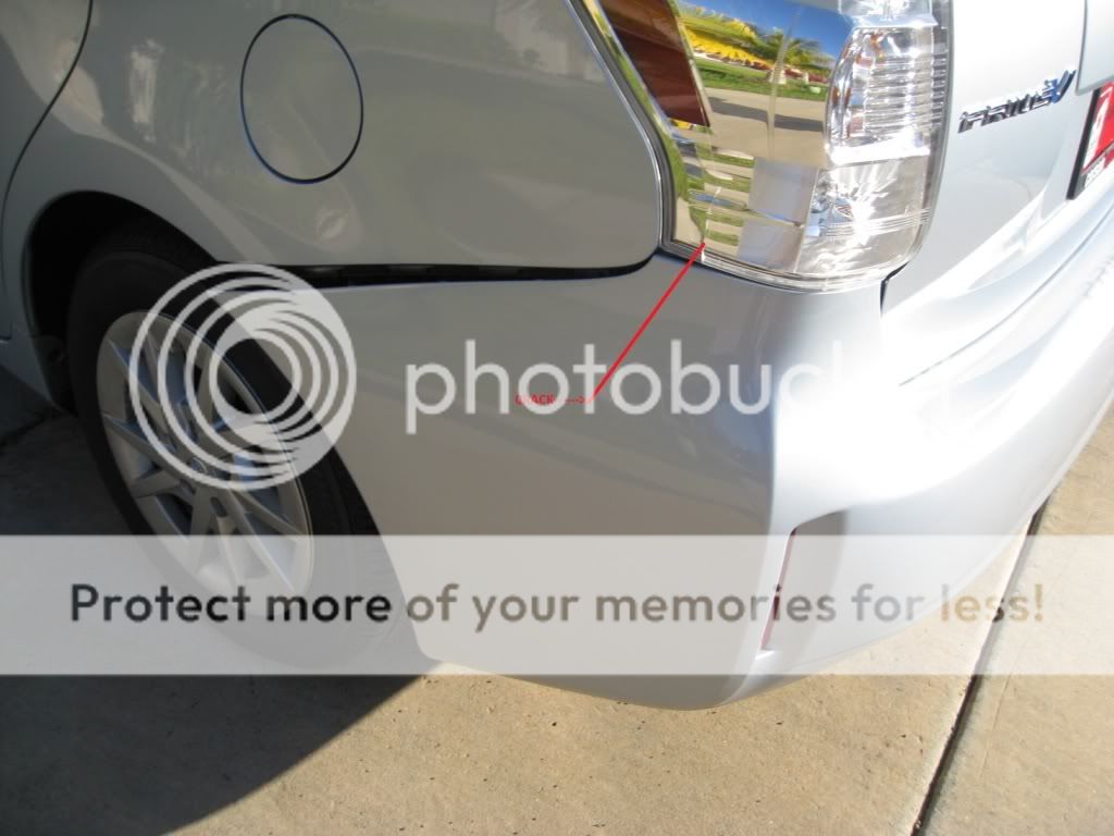

    My three week old Prius v got rear ended this morning :(. It was a chain accident, the traffic in front of me stopped so I stopped, the SUV behind me stopped but I think it was too close to me. I heard a really loud noise, and the SUV was shoved hard into my car. The plastic rear bumper cover of my car got damaged and separated from the metal. When I push the plastic rear bumper forward, it travels about 1 to 1.5 inch. The driver side tail light was cracked but the passenger tail light appears to be OK. I have several questions:
    1. Will they replace the plastic rear bumper cover? Will they buy this from Toyota and the color will match perfectly?
    2. Can they replace the metal bumper? Or will they patch it up or pull it out?
    3. Do you think the car is damaged some how?

    They will replace the cover, tail light and metal bumper with factory parts and then paint with factory color. You will be happy although I'd recommend having a dealer do it. They will closely check the unibody and subframes but you are probably good. They will give you a detailed estimate but won't know everything until they pull it apart. Maybe one week to do the job. Don't rush them unnecessarily. Test drive and make sure you don't have any new rattles or noises.

    Since the bumper cover appears to be cut, they will replace it. They will replace, aslo, the aluminum bumper stiffener and the styro-foam energy absorber.
    Let's hope there is no damage to the body sheet metal of the rear body and the bumber mounts. If they are damaged, they will have to be realigned.
