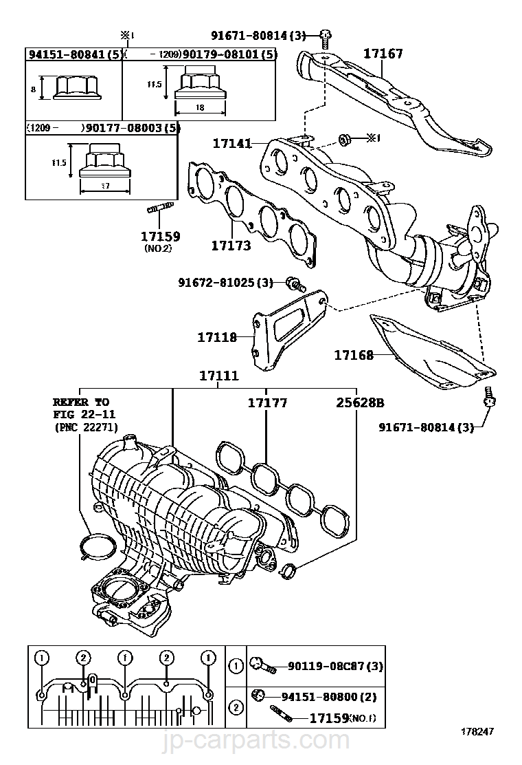

    Out of curiosity, what is the difference between the 1.5L and 1.8L (I know, 300 cc) in so much that the smaller engine doesn't seem to have the same problem? Is the IM made out of different material, different gaskets, anything?
  16. spiderman
    spiderman wretched
    Jul 5, 2009
    7,543
    1,558
    Alaska
    i don't know but i wouldbet the gen 2 is alloy and of course the 3 is plastic.
