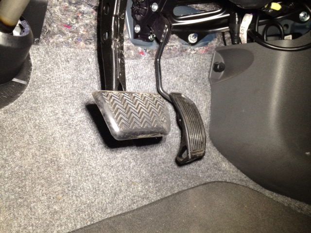

    I slight misunderstanding here, so I apologise if I was not clear. I do not normally have my foot on the gas pedal when adjusting the speed in cruise control. Once cruise is on, I take my foot off and just use the cruise stick on the steering column to go up or down in speed. This is why I couldn't be *sure* if a possible explanation for the pedal movement could lie with the cruise control mechanism.
    I did have my foot on the gas pedal for the SUA events when they occurred, and each time the gas pedal distinctly dropped away from my foot.
    And this remains an important part of the unexplained puzzle - what could possibly cause the pedal movement?

    What of the suggestion that the gas pedal is not releasing fully, leading me to think that the car is accelerating?
    My historical posts will indicate my interests in hypermiling techniques with assisted instrumentation, firstly with the Gen 2 and now in the Gen 3. Over the years, this does develop a sensitive right foot. If traffic conditions allow, my regular practice for pulling away from a stop situation is to gently get the car rolling on electric only (HSI to the left). This was the situation on that first SUA event. There were no other moving cars on that road. The evidence for acceleration was tactile (I felt being pushed into the seat), auditory (I heard the ICE come on and revs increase) and visual (I saw the speed indicator rise and the RPMs rise on the Scangauge to around 1950 - 2100). I had to control and hold the speed with my foot on the brake, removing the tactile evidence of acceleration, but could still hear and see evidence of the ICE revving, all the time until I pulled in to came to a halt, all the time with my foot on the brake.
    Later, I did consider that the car must still have been in S1b of the warmup cycle at that time (coolant temp <40C), but the RPM in that stage (when your foot is off the gas pedal) is around 1280, significantly and noticeably lower. There was a later SUA which took place after S4, which reasonably eliminates the warm-up cycle as a possible link - in other words, it can explain the ICE-on, but not the pedal motion and SUA.
    At this time, I have no other ideas of what could explain the gas pedal motion, and would be grateful to receive any.
    Thanks for the p.m., it is much appreciated. So far I have been fortunate not to receive criticism, although I am we'll aware that there will be many who would view my post with incredulity and disbelief. If you are in this position, do check out my other posts over several years and you will see that I am not that kind of person.
    I did get down, and used a big torch! There was nothing there and also no indication of any kind of 'sensor' under the pedal.

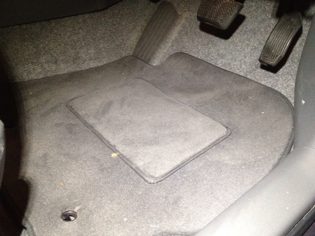

    I decided to replace the floor mat, which if your experience is the best explanation so far received, may prompt the SUA event to happen again. I have another eleven days before the car goes in for 'diagnostics' so there is an opportunity for more testing. These photos show the floor mat back in exactly the position when I removed it yesterday - hooked into place and stopping short and well below the bottom of the gas pedal.
    You will see that I have a minimalist approach to keeping the car clean and clear of clutter - it helps with hypermiling as well!

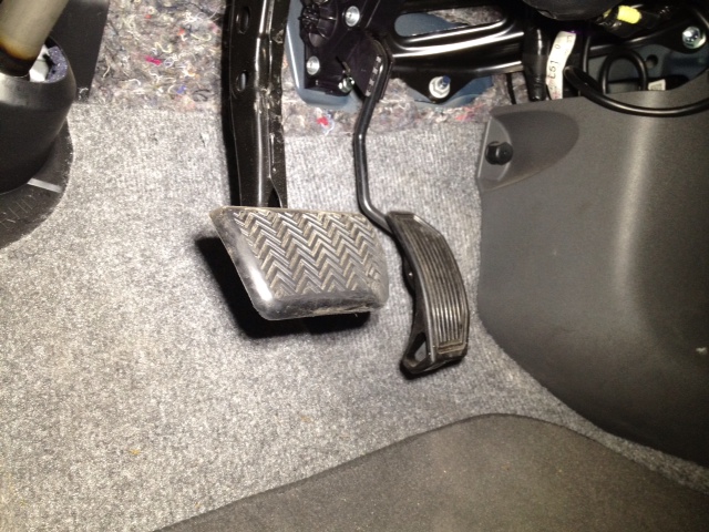

    I just checked and my gas pedal is completely different. It has thick plastic and not metal wire arm. Is this because the LHD vs RHD thing?

    Greenjuice,
    Back when we were all running around in little circles with the original Toyota unexpected acceleration events, quite a bit of attention was spent by various and sundry at exactly how, on the Prius in particular, pedal movement got its way into the engine controller.
    It turns out that in the 2010/2011 models of the time, the acceleration pedal was a spring-loaded arm. At the pivot point were a pair of Hall-effect sensors whose electrical outputs went straight into the engine controller. It's pretty clear that the engine controller did a analog-to-digital (ADC) conversion on the Hall outputs of the pedal sensor, compared the two for sanity, then went on its merry way.
    You'll note that this is true fly-by-wire. There's no cable in there. I've owned cars for quite a time, plenty of which had cruise control. Those cars, some with fuel injection, some without, largely had cables going to the air mass throttle (fuel injection) valve in the air intake or, on the carbureted cars, the throttle valve in the carburetor body.
    In those cars with cables (non fly-by-wire) that also had cruise control, the cable either ran through the cruise control mechanical system or there was a second cable that attached to whatever throttle valve there might be. In either case, when the cruise control was active, as the cruise control added or removed throttle, the pedal in the car would move up or down.
    But, as we're all having fun pointing out around here, the Prius isn't like that. The cruise control is done in software inside the engine controller, which is inside the passenger compartment somewhere. The throttle on the internal combustion engine is directly controlled by a servo with feedback sensors: There's no cable back into the passenger compartment. Finally, there's no actuator inside the car attached to the pedal, which might, if one was madly guessing, be providing that force-feedback that these older cars might have.
    OK. Let's say that you're right about the pedal moving. Then I call loose car-part shenanigans:
    1. Loose bolt that holds the pedal/pedal arm in place.
    2. Loose bolt on the switch that that turns off the cruise control, if there is one. There's one on the brake pedal, for sure; there may be some switch on the gas pedal arm that's come loose.
    3. Wires that have disconnected themselves from on high and are lying across the gas pedal.
    My suggestion: Slide the driver's side seat all the way back, put the back down as far as you can, put your body in there so your head is down where your feet would normally be, and start grabbing anything that looks likely and start pushing and pulling. And looking around. Look for funny draped wires, control cables for the air conditioning, anything that Really Shouldn't Be There. Bet you find something.

    OK thanks KBeck. That makes a lot of sense.
    If the gas pedal is simply spring loaded, with a sensor at the pivot point, and no servo or actuator to provide any force-feedback then it can only be that the pedal must have been physically pushed.
    I can understand why anyone reading this would think 'the OP is a fool'! So I am more than grateful to you for taking the time to respond to my posts!
    So I have had my head down there for the last half-hour, tugging at anything loose. There is only the SGII cable shown on the top right of the second photo, which is held with a tie. I even tried changing my shoes to a larger boot to see if my foot could have been catching on anything.
    I am left with the unexplained yellow triangle when shifted to Neutral and friendly-jacek's posting that his gas pedal looked different to mine, making me wonder if there might be a unique spec to this car (the 'Safety Pack' option was a bit pricey and perhaps not popular).
    Your post has given me some leads and I appreciate that very much.

    Just looked at mine which is an early built 2009 RHD gen3. It's exactly the same as far as I can tell, including the little curl round part at the bottom of the accelerator.
    Wonder if the US spec has a special one?

    I spent the last week trying the reproduce the SUA with no success. I even found an old spare car mat and doubled up on the existing mat (secured with cable ties) for a few days just to test out Grumpy’s experience, as he is the only person who has posted an experience like mine.
    I also tested out all several situations of shifting from Drive to Neutral to see if I could get the yellow triangle and alarm to come on. Tried it while accelerating briskly, while accelerating in Cruise Control and also with ‘Resume’ on C.C. Same result each time – the car just ‘pips’ once, no alarm and no yellow triangle.
    Today, I prepared the car as I always do before a service. I emptied it of all contents; checked the mat again and took a reading on the trip meter, before driving it to Jemca.

    c ) they tell me that when they found the car, one side of the drivers mat had come off its clip and the whole mat was found rotated and slipped under the accelerator!
    You all know from my previous postings how aware I was that the mat is always to be blamed first. The journey to the garage was 4.6 miles. I had checked the mat obsessively over the last 2 weeks *and* before I left the house. There was *no way* I would have left the mat in a position like that, let alone without realising it!

    Don't do the following when the car is in Ready.
    Get the Toyota rubber mat, pop the carpet mat on top and carefully let it slide under the accelerator with it depressed ever so slightly (like when you're doing 30 mph) and see what happens.
