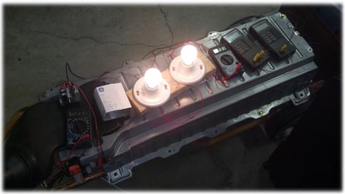

    Just to sum it up, I want to build a simple discharger as pictured, to drain the all the modules together. For no other reason than, I need my car, and dont want to wait until next weekend to start the charge/discharge cycle. I think that a single bulb would be easier and completely compatible, but I am not an electrician. All my electronics knowledge comes from physics, and only part of that was electronics. If anyone out there thinks of a solution, preferably something i can make at home I am all ears.

    Do you know what voltages to charge and discharge to? Do you have pack cooling setup and monitored?
    How do you plan on measuring IR?
    Until you have those ( at the exteme minimum ) in place, my advice is to wait.

    The Toyota packs peak voltage is too high for a single bulb discharger. It will blow the bulb. The solution is two bulbs wired in series. Because they are in series, the bulb wattage selection does not change between the single and dual bulb versions: Hybrid Automotive - Simple Discharger User Guide
    I normally use the 200W, 75W, and 25W bulbs when deep discharging. The table on the website is meant to be a guide, it's ok to deviate from it if desired.
    People are reporting very good result from cycling the pack multiple times via a deep discharge. The lower people are draining weak packs, the more success they are having rejuvenating them. Here is one recent account from a Honda Insight owner who has been using a grid charger and discharger to extend the life of his battery relatively weak battery for multiple years:
