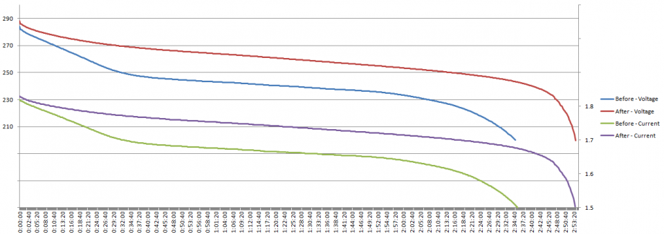

    Prius battery packs have a finite life cycle, just like all NiMh batteries:
    Reduced capacity due to crystal formation within the cells and voltage imbalance is extremely common. The vehicle cannot correct the memory effect and imbalance problems on its own. When used as preventative maintenance, our Prolong™ Battery Systems will break down the memory effect and restore cell balance. We have scores of fleet & private party 2010-2015 Prius owners using our systems to prevent battery decay from occurring.
    Here is a before & after example of using our systems on a 2009 Camry Hybrid. The car had ~130k miles and no codes of any kind. Our systems increased the usable battery capacity by 12%:
