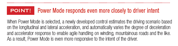

    On Gen3 I use the PWR mode on the highway at high speed (140km/h+). Otherwise for regular driving I find it to "jumpy" and very hard to fine tune the accelerator position to manage pulse&glide or avoid too sudden acceleration. Moreover (like in normal) in winter it makes the engine run more to keep the cabin warmer, than in ECO.
    I am essentially always in ECO in the city for fine tuning of the pedal. Normal in suburban driving (even in winter since the car is using the ICE a lot more simply because it is moving a lot longer, instead of staying still in traffic jams or traffic lights) and PWR mode in a few limited situations because I feel lazy pressing the accelerator more. Toyota claims that the PWR mode takes into account the steering wheel position and the accelerations the car is subjected to, to tune how the engine will respond to acceleration (e.g. I suppose it will not turn off the ICE off when going out of a bend, and instead do that when going downhill). Gen3 PWR mode is simply mapping more aggressively the pedal position to the power request from the drive train. I noticed it tends to keep the ICE on more often when releasing the accelerator though, I think to make sure the battery (giving the "oomph") is charged enough at all times to support more the ICE in accelerations.
    There were speculations, based on a Lexus website/document (I forget exactly where I read that, back in the day it came out) that in PWR/Sport mode the CT200h (same exact drivetrain as the Prius Gen3), would enable 650V on the MG2 from 0 accelerator pedal press, compared to 500V in ECO and normal in all (?) or stronger pressed pedal positions. But it was never really tested or proven on Gen3 that I know of.
    In any case, if you floor the accelerator, in *any* drive mode, your 0-60mph/100kmh is still 10secs, at least on Gen3 - nothing faster... I expect the Gen4 to do *exactly* the same if you floor it, regardless of mode.

    My understanding is that the throttle mapping curve changed based on steering input in PWR, on the Gen 4, but that was about it - not actually changing engine off strategy or anything. Honestly, when I was test driving the Gen 4, even when getting a bit more spirited with it, I preferred the linearity of Normal (which, on Gen 4, is actually linear).

    That is true for the Gen 3 Prius. I think the Gen 4 Prius is a bit smarter and using PWR mode in spirited driving will result in a more responsive drivetrain as the computer learns.
